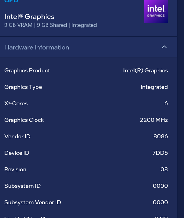

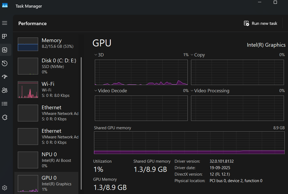

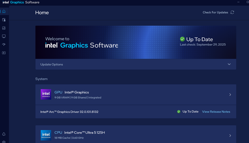

It is showing Intel (R) Graphics  in Task Manager and in DirectX Diagnostic tool . My Laptop is Acer Aspire Go 14 with intel core ultra 5 125h with 16 gb ram and 512 gb ssd . Screenshot 2025-09-29 235015.pngScreenshot 2025-09-29 235045.pngScreenshot 2025-09-29 235151.pngScreenshot 2025-09-29 235258.pngScreenshot 2025-09-29 235637.pngScreenshot 2025-09-29 235700.png

Hi Deepakmeena,
Thank you for your patience while I investigated this matter further. After replicating the issue on our end, we discovered why Intel(R) Graphics is showing instead of Intel ARC Graphics.
Here are the details:
  • DDR5 memory has an internal dual-channel architecture of 32-bit x 2, which does not qualify as a true physical dual-channel configuration.
  • For optimal performance, a physical dual-channel memory setup must be:
    • 64-bit x 2 for DDR4, or
    • (32-bit x 2) x 2 for DDR5 — meaning two separate RAM sticks.
Therefore, to fully unlock the performance of Intel® Arc Graphics, a genuine dual-channel memory configuration is necessary.
For more information about this laptop’s pre-installed RAM configuration or assistance with RAM upgrades, please contact ACER support directly.
