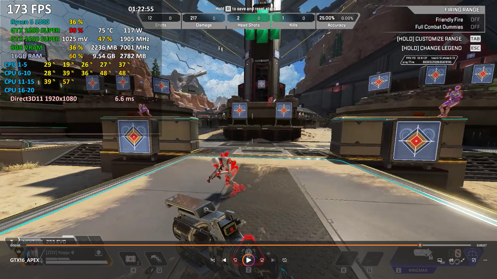

Not so long ago, I bought an arc a750 instead of my rx6400. At first everything was fine, I was very happy with the purchase, but when I went to play Apex (basically, I took it specifically for Apex), I was horrified by what I saw. FPS is catastrophically low for this graphics card.
In places where, as I understand it, there are few objects in the field of view, everything works well, but when you look at the entire map, trouble begins here.
I compared the A750 with my brother's GTX1660 SUPER graphics card and was surprised at how smooth the picture was and how much more FPS there was. And this is only in Apex! For example in "Ghost of Tsushima", the A750 performed better, well as in other games except Apex.
I attached a pics with a comparison, as well as an SSU with both graphics cards, in case it helps somehow.
I have already tried reinstalling windows, reinstalling drivers, reinstalling the game from hdd to ssd. Play on both Steam and EA - nothing helped

Hi, are you running Apex in DirectX 12? If not you need to put this in your launch options for the game in Steam.
-anticheat_settings=SettingsDX12.json
I have a 750 and sometimes play Apex, I actually cap the fps in this game. See how you go with dx12.
Oh my God, it really works, thank you so much. There was finally a smoothness.
I tried to write something similar about SettingsDX12 there, but it didn't work, so I thought nothing would help me anymore. Thanks again, it helped me a lot.
