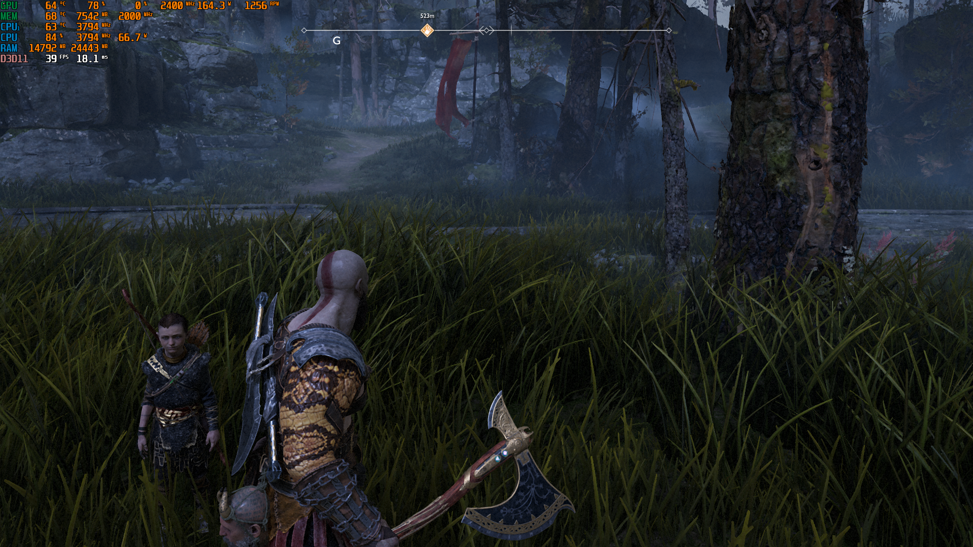

Hi Mike, thank you for your reply.
1. I updated the driver from Intel Graphics Software and selected the clean installation option.
2. I cleared the shader cache, checked the resize bar (on), and cleaned temporary files.
3. Epic Games.
4. I've attached a screenshot of the game settings.
5. I created and attached an SSU log.
6. I recorded a CapFrameX video longer than 5 minutes and attached it. I've applied all the CapFrame settings mentioned in the "Please read first" section below.
Finally, I'd like to add that I took an in-game screenshot the day I started this thread, and I've included the FPS from that time and the current FPS. (22 FPS from the day I started the thread, 50 FPS from today)

Hi Mike
I downloaded the latest version of DDU from the link you provided, uninstalled the driver in safe mode, and restarted.
Then I downloaded the latest driver from the link you provided (gfx_win_101.8509) and restarted.
After that, I checked for Windows updates and updated a driver called "Intel System 32.0.101.5542" and restarted.
As a result, I launched the game and saw that my problem was not resolved. I'm attaching screenshots below.
Unfortunately, the problem persists.
Thanks.
