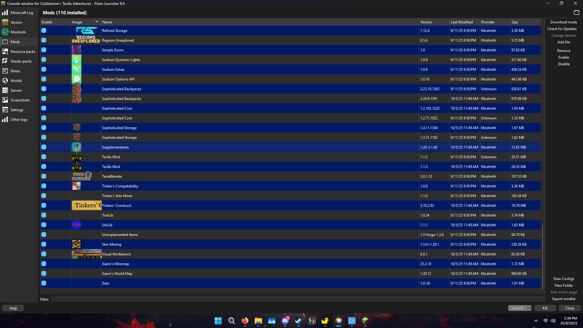

Hi!
So I've been trying to play Minecraft since i got my Arc B580, but i've always been getting performance WAY lower than what I got previously, and it does not make any sense. I'm providing my video settings along with my latest.log file and a Capframe Log along with my most recent SSU log. Let me know if you guys need anything else.

Hi Von! Nice to see you again!
No, there haven't been any recent software or hardware changes. When i refer to the higher performance, I am referring to the performance I was getting on my Radeon RX 6650 XT. Nothing has changed since besides changing from that card to the Arc B580.
I am running the Java Version of Minecraft, and my current mods are included in my latest.log file, but I will provide screenshots of my modlist through Prism just in case. I am also using Solas Shaders and Vanilla Tweaks for my shader and resource packs specifically.

Finally got around to testing, I'm now on driver version 32.0.101.8250, and I tested on both a vanilla 1.20.1 installation, my modded 1.20.1 installation, and the latest snapshot as of time of writing.
One thing i noticed is that turning RTSS off (After having to kill MSI Afterburner as it kept auto-starting RTSS), the performance did increase quite a bit on the vanilla and modded 1.20.1 installations, with FPS numbers jumping from around 90 to 110, but Shaders on the modded barely improved. on the latest snapshot, with RTSS, it was getting around 100-110, but after turning RTSS off, it stayed around 120 (which was where vsync was), with stuttering when a bunch of new chunks were being loaded. That I can attribute to my Ryzen 5 5600X.
