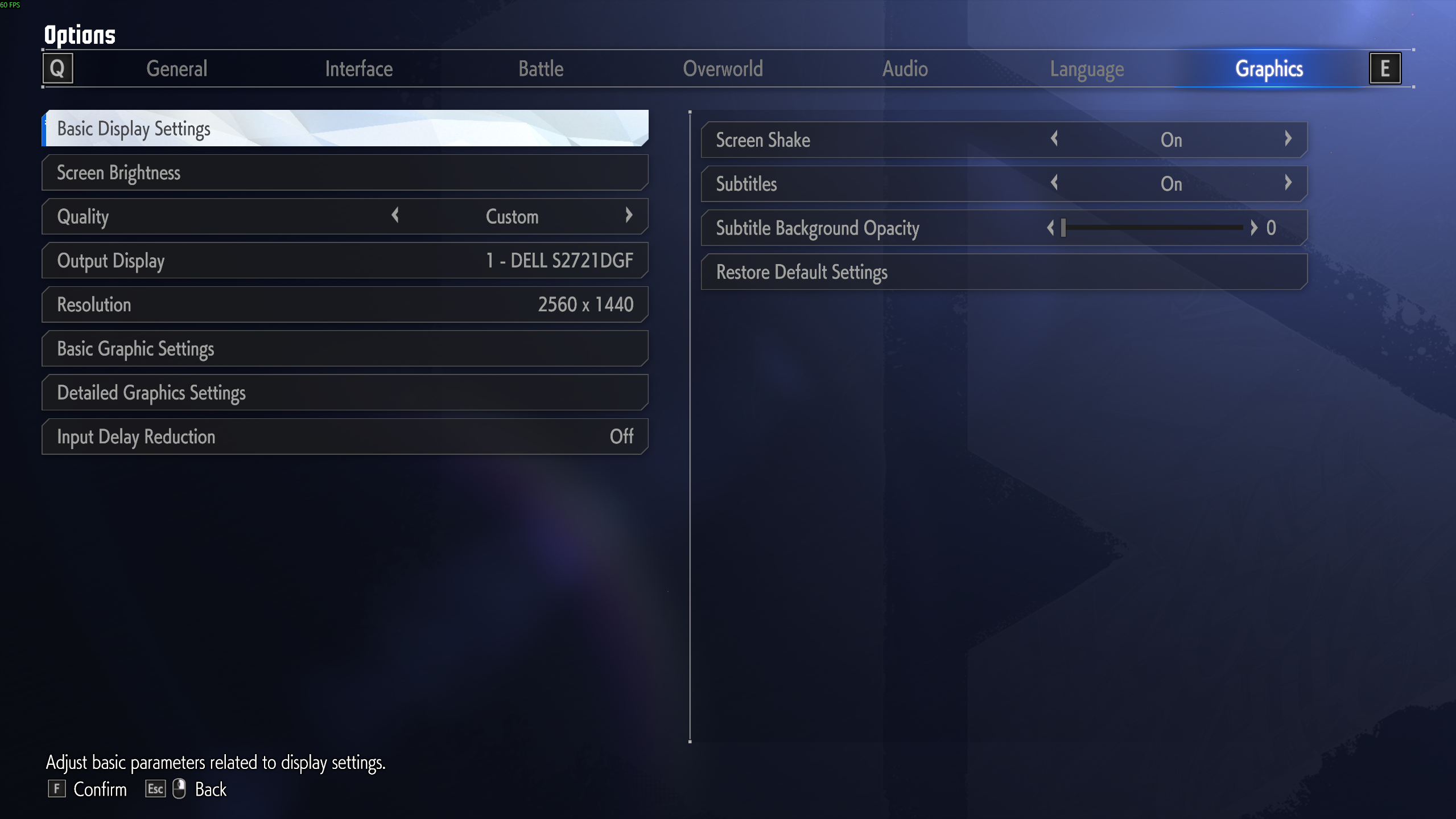

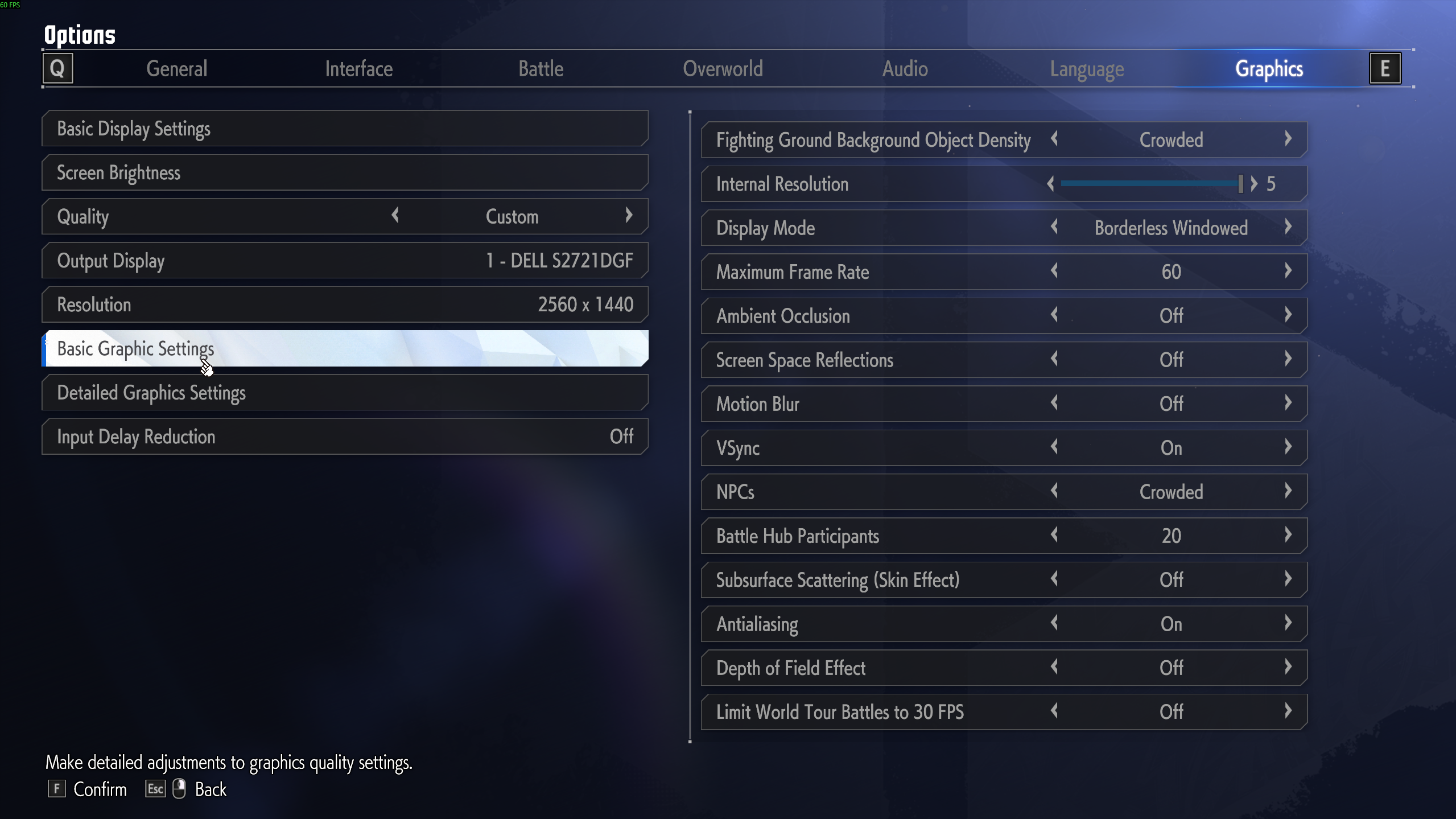

sleepingtoads
6,304 Views
Yes, and I just experienced the crash again. Steam crash report attached. Prior to this crash, I performed a clean install of driver version 32.0.101.8250, which is the latest available.
I took screenshots of the graphics settings I was using. Basically I have everything turned up to high except the maximum framerate, which I capped at 60. This usually happens in Fighting Ground modes, which I believe is capped at 60 regardless of that setting.
This time I booted the game and claimed a Drive Ticket reward, then immediately selected Fighting Ground. I went into Arcade -> Story, then selected Kimberly. I also attached 2 screenshots of the story mode settings selected. I won the first match against Luke in 3 rounds, then won the first round of the second match against Guile. The crash occurred as I was attacking during round 2.

Thanks for the update, and I appreciate you sharing the additional crash report. I went ahead and ran extended tests on my end using the latest driver 32.0.101.8250, completing 12 matches in Arcade mode along with several retries, and I wasn’t able to reproduce the crash. To give you full visibility, here’s a video capture of my test session: https://www.youtube.com/watch?v=g9bP5N1beEY
In the meantime, please try the following steps, as they’ve helped in similar cases:
  • Adjust your graphics settings and test with V-Sync disabled.
  • If the behavior persists, reinstalling the game is a solid next step to rule out corrupted files.
Once you’ve tested these, feel free to send any new observations or crash logs. I’ll keep digging until we land on a definitive fix

sleepingtoads
5,709 Views
Hi Von,
I turned off V-Sync and managed to play a few hours with no crashes. I will update you if I experience any more. Thank you so much for your work on this!
