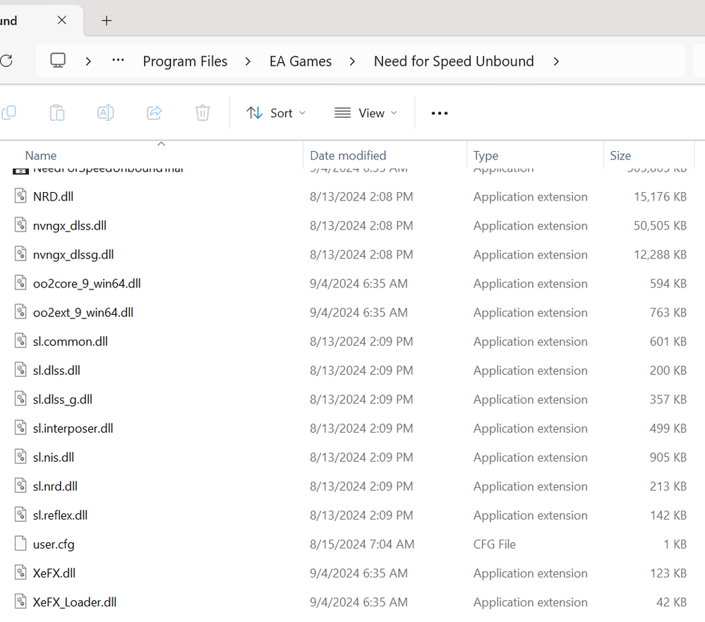

Though below create a user.cfg containing following
e.g. on your desktop open notepad
in it type or copy paste the following which should be specific Intel Core Ultra 5 135H CPU/s
Thread.ProcessorCount 4
Thread.MaxProcessorCount 4
Thread.MinFreeProcessorCount 0
Thread.JobThreadPriority 0
GstRender.Thread.MaxProcessorCount 8
 Then save the file with a .cfg extension
Copy it to the game folder where need for speed unbound is installed, should look like the screen shot below.
