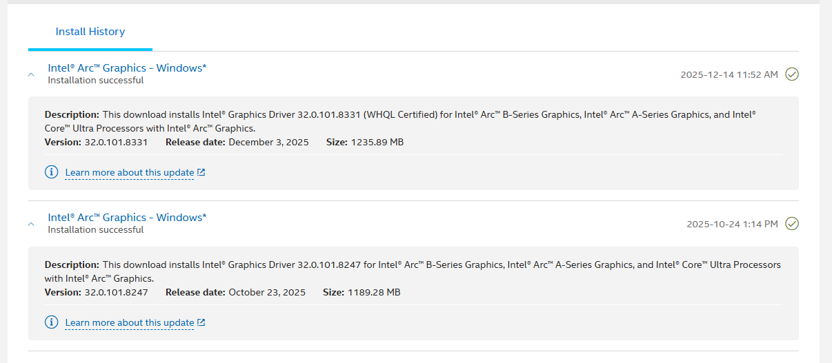

Hello, I've recently bought an ASRock Challenger OC Arc B580 2 months ago and it works wonders. After updating the drivers to latest, it was working fine for a couple hours. I was using Davinci Resolve to edit videos until later, my entire PC had a terrible lag and I got a "Faulty Hardware Corrupted Page" BSOD. I tried to boot up my PC again, there's power but shows no display. I've tried taking off each RAM stick, still no display. Tried re-seating the GPU, no display again. I connected my HDMI to onboard graphics, booted in safe-mode and used DDU to clean reinstall and revert previously installed driver version but I cannot install the previous driver because the GPU doesn't get detected by the system even if it is connected. I tried putting the GPU to a different PC and it wasn't being detected as well. I'm afraid that the problem now probably lies with the GPU itself but I am not completely certain.
My System specs:
  • Ryzen 5 5600G
  • Biostar B450MHP v6.3 version B45NS905.BSS
  • Deepcool PF700x 700w Bronze
  • 16GB DDR4 3200Mhz
  • Windows 11 Pro 10.0.26100 Build 26100

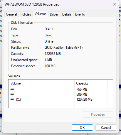

I see that my main partition and my HDD are set to MBR. I saw a post related to what you said and I was curious to do so since their issue a bit similar to mines was fixed when they've converted to GPT. I am new to doing this so if it's okay for me to ask questions before proceeding to what you suggested:
1. Will this have some complications on older disk hardware?
2. Since I've seen that GPT is recommended on Windows 11, having MBR on my main partition didn't had any issues regarding on other components until updating the B580. Will this be able to future-proof anything related to firmware changes?
Thank you once again for this information!
AlHill
18,019 Views
Here is a link to arc requirements:
https://www.intel.com/content/www/us/en/support/articles/000091128/graphics/intel-arc-dedicated-graphics-family.html
Under "operating system", you will find a link to microsoft regarding mbr2gpt.
Complications with other hardware?  It should not.
Future proof?  You should have been on UEFI in the first place.
Make sure you have a backup before you do anything.  There is a lot of information on mbr2gpt on the web.  Read it first before attmpting to convert to uefi and gpt.

euclaze
17,825 Views
Hi again
I've changed the BIOS to UEFI, enabled secure boot, turned off CSM and enabled both 4G Decoding and ReBAR. I have also made a fresh reinstallation of Windows since it's been almost a year and a half since I last did, as well as converted my boot drive to GPT. Unfortunately, the GPU still isn't giving display and undetectable.
