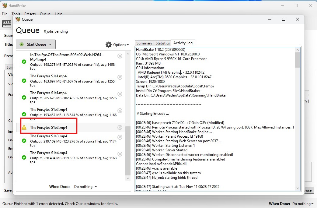

I just got my first botched encode with HandBrake using ARC Driver 32.0.101.8147 WHQL Certified
If you look at the picture I encoded The Forsytes S1E2 The Forsytes S1E3 and The Forsytes S1E4 in a row and for whatever the reason The Forsytes S1E2 failed but The Forsytes S1E3 and The Forsytes S1E4 encoded just fine.
I was able to go back with the same setting's and encode The Forsytes S1E2 the second time with no problems what so ever.
I'm uploading 2 pictures and the SSU Log as well.

@KennethB_Intel
I was finally able to get another botched encode with HandBrake and get the encode to fail and I got the HandBrake Log and also a screenshot of what the fail looks in HandBrake.
I was running Arc Driver 32.0.101.8247 and it was the Non WHQL I also tried the 32.0.101.8247 WHQL Certified driver and I'm pretty it also gave me failures as well but I never got any screen shot's.
To this fail I did around 35 encodes before I could get a fail and on another night when I finally got fed up and tired with all the fails I got that night which I did 12 encodes and 4 of them failed.
I uploaded the files to this message so you can look at them.

Laroldski
15,233 Views
@KennethB_Intel
If you look at the bottom of the log file you I uploaded you can see there's and error there called  # Job Failed (-12) I did some looking on google that had the error code and it looks like there was a problem for some people when they ran HandBrake v1.5.1 and I'm running HandBrake v1.10.2 and the only thing I know is the older ARC driver work well with no performance loss for video encoding or botched encodes.

Laroldski
15,161 Views
@KennethB_Intel I ran HandBrake on my old Windows installation and there's a picture of Task Manager and the Intel Graphic's software as well.
In Task Manager it say's in the picture it was using 46% but it was using 50 to 61% most of the time bouncing back and forth between 50 and 61% just to be clear.
I'm going to do a new installation of Windows now and when I'm finished fully updating my pc I will run HandBrake with the latest driver.
Also please keep in mind it can take as many as 30 to 40 encodes before an encode fails.
