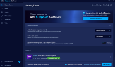

Before updating to 32.0.101.6737:
After updating to 32.0.101.6737:
After updating to 32.0.101.6737 (changed language back to english so you can understand)
Of note is the settings don't reset immediatelly. To reproduce this I had to
- Install the update
- Close IGS myself
- Wait a few minutes
- Reopen IGS
Also obviously the language won't change if your system is already in english. It changes from "English" to "Use System Default" so this only affects Windows installations that aren't in English

RandyT_Intel
9,403 Views
Hello @djmrFunnyMan,
We are actively working on the graphics settings issue you reported and are committed to resolving it as swiftly as possible. To ensure we address the problem accurately, I need to clarify a few details regarding your testing method:
  1. After updating the graphics driver, do you reboot the system, or do you simply close the Intel Graphics Software and restart it manually?
  2. During the driver update process, do you use Display Driver Uninstaller (DDU) for a clean update, or do you utilize the update option within Intel Graphics Software (IGS)?
  3. When you press "reset settings," are you able to revert to your previous settings, or is this option also affected by the issue?
Your feedback on these points will be invaluable in helping us pinpoint the cause and implement an effective solution. Please let us know at your earliest convenience.
Thank you for your cooperation and patience. We look forward to your response.
Randy T.
djmrFunnyMan
New Contributor II
9,391 Views
1. I simply closed the IGS window and waited a few minutes
2. I utilize the option within the IGS
3. I don't understand this question. The issue is that my settings are being reset to default after an update. What is pressing "reset settings" myself supposed to achieve? It will just reset the settings again. It's impossible for this to restore my previous settings as they are not the defaults.

RandyT_Intel
9,275 Views
I wanted to inform you that I have coordinated your case internally to ensure a smooth resolution.
To proceed, I kindly ask for your clarification on how you perform updates on your system. This will help us provide you with the most accurate guidance.
Regarding the driver installation, please note the following expected behaviors:
  • Setting the installation mode in IGS to "Clean" will reset all your current settings. This option is ideal if you wish to start fresh without retaining previous configurations.
  • If you prefer to keep your existing settings, we recommend using the "Express" installation mode. This option will preserve your current configurations while updating the necessary components.
Please let us know your preferred installation mode or if you have any questions.
Randy T.
djmrFunnyMan
New Contributor II
9,243 Views
I use "Clean" installation mode in IGS because from my experience, using express mode will lead to problems over time (not an Intel issue, that's how it is in general for driver updates for AMD and Nvidia as well)
I would say the settings resetting themselves after a clean driver installation is unexpected and confusing for the following reasons:
- That's not how it works for other vendors. ie. downloading a driver update from the Nvidia app and setting installation mode to clean will not reset the NV app settings.
- I am installing a driver update. I don't see why a clean driver update would nessecitate resetting IGS as well since its a different piece of software.
- The settings being reset are purely prefference and have no impact on the GPU driver. My language settings and preffered installation method have no impact on the GPU behavior. I'd understand stuff like overclock tuner and post processing settings being reset but not this.
