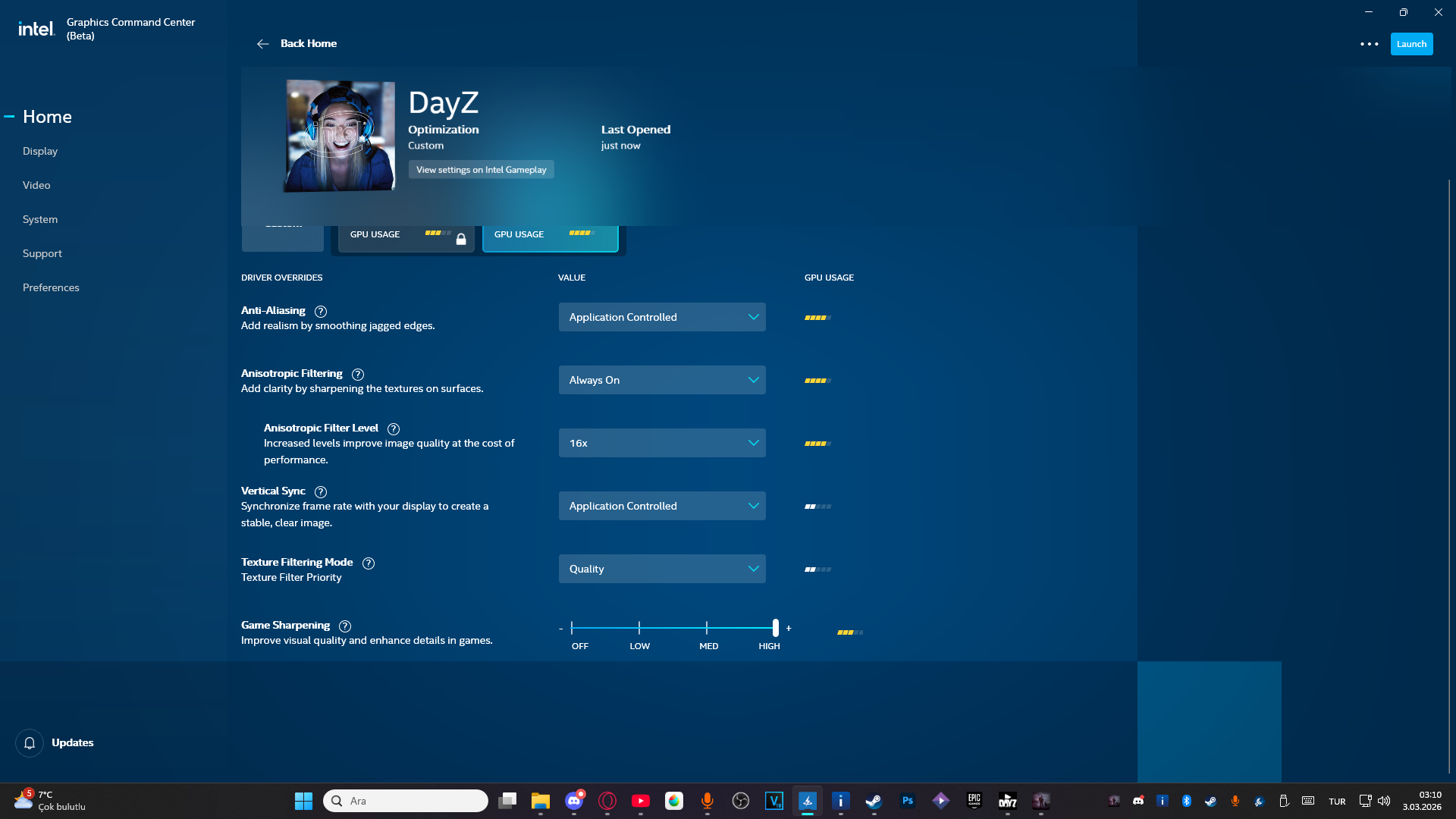

Now i will kindly put the SSU log and the pictures here. Just to remind, i have adjusted the settings yet this appeared when i tried to choose "Intel Optimized". I Have also tried to use these settings with PUBG and The Forest which didn't worked. Even though they were automatically detected by the IGCC.

And here is a proof nothing changes with the Sharpening setting also i tried with closing the game and tried to launch it again yet it didn't worked. Same goes for all filters.

Firstly I appreciate your efforts on resolving this issue. But may i know which games you tried this sharpening on?
In DayZ i can't see a difference to be honest. Since this setting doesn't really look like it is Dx11 or Dx9 supported it looks more like it is game supported. What made me believe in this is the fact the setting is dependant on Game to game and not available in the Global settings. I must inform i have just performed a clean system reset and there are just few things i downloaded. This is the list of "everything" i downloaded since (like everything maybe associated maybe not even relatable with the issue);

There's actually a very slight difference between but that difference alone doesn't improve the visual quality itself. The difference only seems to effect the small film grain on game. Just very small difference between the images. Not what's shown on the Intel Graphics Command Center. Both in Amd and Nvidia when you turn on the sharpening filter even to %10 there's more difference. If i could've potentially used ReShade with no risk i could've but it is risky. I Think Sharpening has to be improved because the Sharpening filter can be barely noticed with what you're sending me Mr.John. But still Intel has to improve the quality even just because what is has promised to us with the sharpening filters demonstriation on IGCC. Could that be fixed?

I'm all fine with PUBG being the reference game but i want to mention that PUBG itself has an in-game Sharpening filter in the settings. Just saying but the difference between IGCC Sharpening on or off would be more visible if the issue can be adressed and fixed. Wishing you the best of luck.

- Game Sharpening Settings
- Please share the exact configuration currently being used for Game Sharpening (you may attach a screenshot if available).
