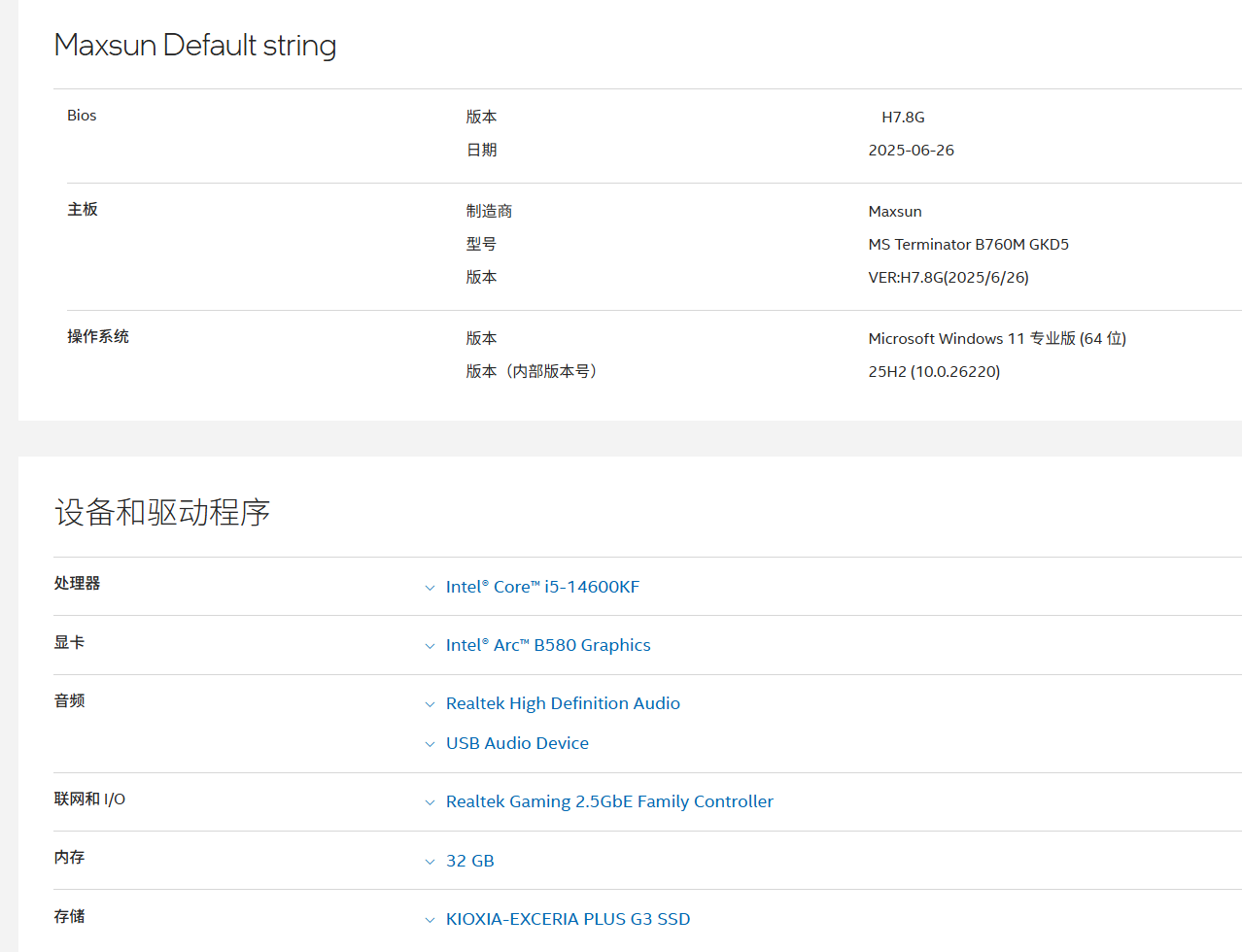

1.The hardware information is as shown in the figure.
2.Adjusted the in-game graphics settings and updated the graphics driver settings, but no improvement was observed.
3.The game was installed a long time ago. It previously ran on an NVIDIA 2060s graphics card, but after switching to an Intel Arc 580, the performance difference became very noticeable, with the overall graphics appearing much rougher.
QQM
7,344 Views
QQM
7,479 Views
4.The resolution is set to 2560x1440, and the overall mode is set to ultra HD. Regardless of how other options are adjusted, the issue of inconsistent shadows or lighting cannot be resolved.
5.The current driver version is 8250.
