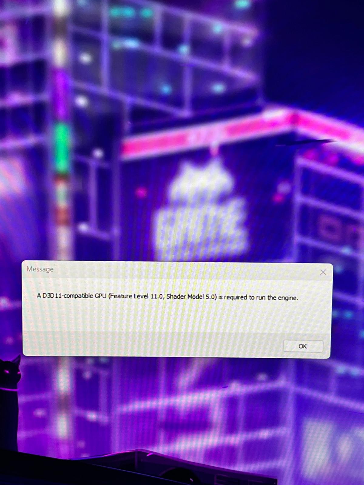

It's been more than a week that i cannot open Valorant because of the graphic card updates. It was working perfectly before that. Normally I use Intel Graphics Software to update them. I've talked with Riot and the problem is even though i regularly update my drivers it wasn't updating itself.  So they suggest me to download and install the Intel Iris Xe Graphics manually. After the update i could open the game without any problem. However while I was playing the game ,I am assuming it happened when i got the update, it was frozen and I could not open the game again. Right now I cannot update i tried to download manually it did not work. Will I get this error when I always get the update? How can I update it?

3) I do not get any error codes but I can send you the screenshots that shows the errors.

 Based on your system information, Intel® Graphics Driver 32.0.101.7076 is the most recent driver available for your Intel® Iris® Xe Graphics. However, since this version is causing installation issues and the Intel Arc & Iris Xe Graphics 101.7029 version successfully allows you to launch the game, I recommend continuing to use the working version for now. I just noticed a discrepancy in the SSU log file. While you mentioned that you've successfully installed 101.7029 and launches the game well, but the SSU logs shows driver version 32.0.101.6790 as currently installed, could you please confirm on this?

Normally before the new update I could launch the game with Intel Arc & Iris Xe Graphics 101.7029 however after I got the new update Intel® Graphics Driver 32.0.0101.7076  notification I could not launch the game even though I did not installed. Yes, I mentioned that I've successfully installed 101.7029 and launches the game well however when I got the notification for 32.0.101.7076 I tried to install with clean installation. I could not update as a result I have 32.0.101.6790 driver version.
1) I tried to go to device manager but it did not change anything for me.
2) It does not change whether I do clean installation or not, it won't update itself.
I only have freezing issues while playing Valorant and especially Marvel Rivals rather than that I do not have freezing issues normally.
I would also like to point out that after a while after the new update is released, even if I try to update during that time, it fails, and when I try the update again, it succeeds. Today I could update my drivers however I could not launch the Valorant until today when I update them.
