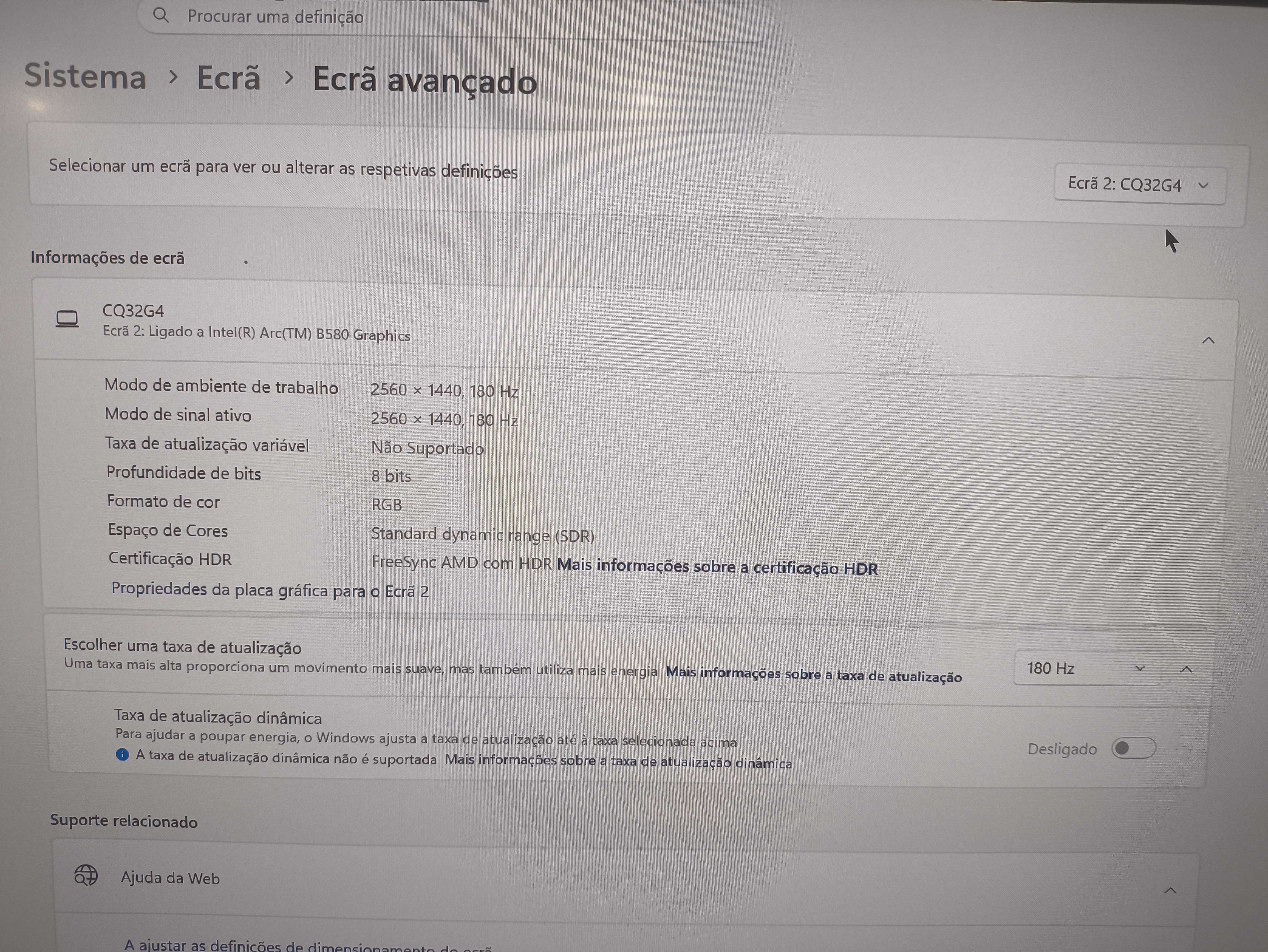

Hi John M
Sorry. that was my mistake. I tried the merge by downgrading from all resolution and in some point in time I forgot to put back on 180 hz
Here goes the resquested pictures of the individual monitors at 2560x1440 180 hz and merged in the 10240x11440 180 hz
The new SSU reports are provided also
Best Regards
Ze Mike

Hi John M
All the recomendations sugested in the troubleshooting were already tried with no positive result.
There are no problems with the monitors or resolution when they are solo. Even if I combine any two of them the resolution is Spot On.
The problem seems to be some software issue in the Intel Graphics app about combining the ARC B580 and the 3 monitors, or at the very least my AOCs model, because if it supports 10240x1440 should support 7680x1440 even better
Hope te ear some kind of fix to this issue from you
