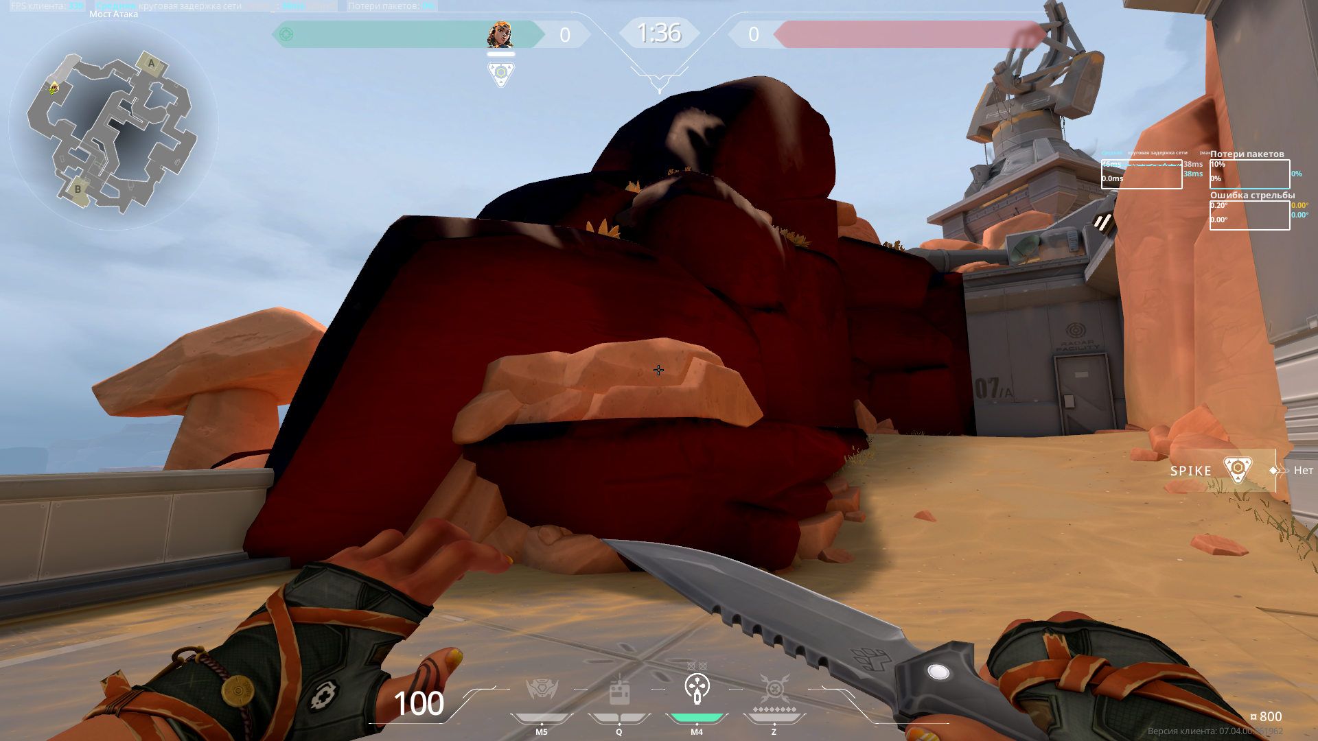

Hello, a few weeks ago I noticed that on one map in Valorant colours of rocks changed that was looking a bit creepy, also a grass on other map became black, I've tried to reinstall the game and drivers to Intel Arc A380, but colours are still the same. I've contacted with Riot Games support and they said that this is drivers issue.

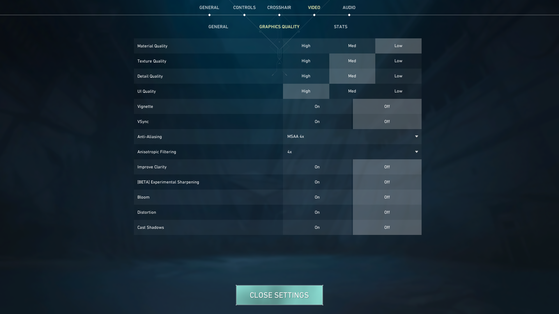

If the issue persists, we would like to get more details in case we need to test this in our lab, please let us know the exact steps that can be followed to reproduce this problem and the names of the maps in which this issue happens. In addition, please share with us a screenshot of your in-game graphics settings, or let us know if the issue happens regardless of the settings configured.

Hello, I've tried to reinstall drivers, but it doesn't help. Problem with textures are on maps Fracture, Haven and Sunset. Also, I have a bug with interface like on screensot. I don't know exact steps that can be foolowed to reproduce these problems, but maybe? I can send any logs if you need it.
