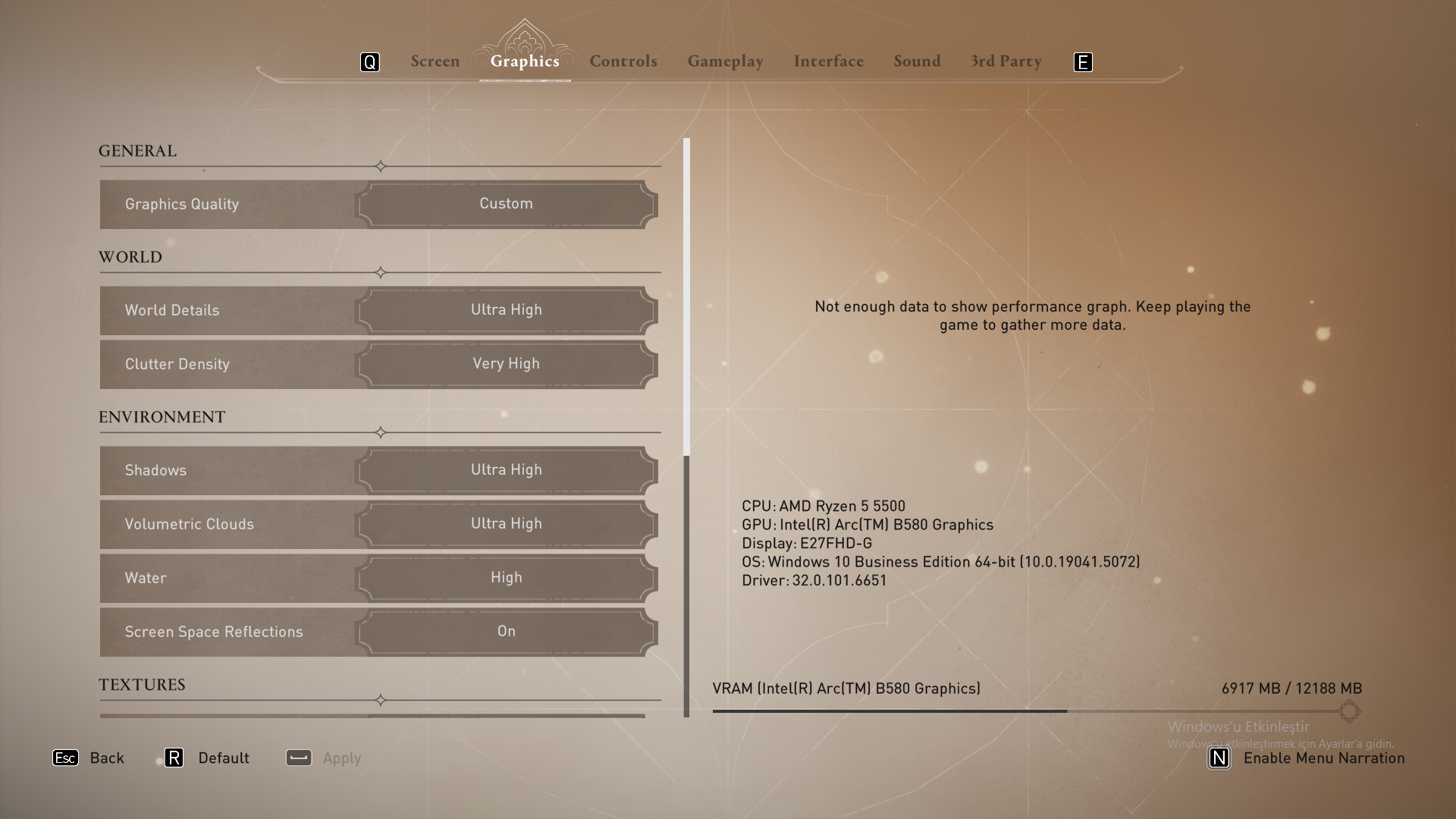

I am currently experiencing a issue where i can't see xess setting on 2 xess supported games i have. I checked for a solution and as far as i found out, i tried disabling iGpu (even tho i don't have a integrated graphics cpu), i tried using ddu and have a clean setup and i tried to disable dynamic resolution upscaling but non of these methods has worked for me. I tried enabling XeSS in Assassins Creed Mirage and Ghost of Tsushima non had a option to do so. I wonder if anybody does have a idea or a solution for this verily bad situation?
Arc B580 12gb Limited Edition graphics card
Ryzen 5 5500 processor
Apacher Panther 8x2 3200mhz CL16 DDR4 Ram
A320M-A Pro Msi motherboard
Windows 10 Pro 22H2
Gigawatt 550w 80+ bronze Psu

Hi Mr.Dean R.
I also appreciate your patience and your prompt response. Here are some answers which may help:
1. I tried using DDU before contacting the Intel Support and today. It doesn't seem to be working with the issue.
2. The issue first started when i bought this card on 15th of February, First thing i did was testing the card on games Assassins Creed Mirage didn't had a option to activate XeSS when it just did had a option to do on yesterday of that day.The Assassins Creed Mirage i owned was from Epic Games.
3. Yes I'm completely mentioning the "Upscale Method" in the game settings of Ghost of Tsushima.
4. The Ghost of Tsushima is cracked. Cracked games also should have XeSS i tought this might happen because it is cracked but the issue is still ongoing with Assassin's Creed Mirage.
5. Yes it completely disappeares.
6. Today i wanted to test out the XeSS on few more games and i downloaded The Berserker Khazan's Demo version, the same thing almost happened there but apparently i forgot to turn on DirectX 12. After i turned DirectX 12 on i was able to play with XeSS. But this is not the solution.
I also downloaded Assassin's Creed Mirage from Epic Games today to test out if XeSS works or not, it wasn't working the option was not there at all. Perhaps this is likely a driver cause?
