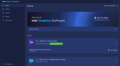

intel graphics sopftware shows 2134 driver for the uhd 630 installed even though the latest is installed.

yes i manually installed the 630 driver.  and yes both drivers show their own versions.    the drivers are installed correct.  the arc software just seems to pull in wrong info.  here is whats installed.
i will try installing 630 driver first and then installing arc driver so see if the arc software shows correct driver in the software.

ok so its very specific and hopefully can be fixed in your future updates.
first ddu drivers.  reboot. here is pic of drivers fully unistalled under display adapters is the arc A770. the 630 is the other devices. i manualy installe the 630 driver through the device manager update and selecting the ini file.  ive also tried installing via exe.  same issue.
install a770 driver
i cant select clean here otherwise it unistalls the 630 driver.    if i install the 630 driver after the a770 driver the Arc software shows the 630 driver version...
after reboot.
now in the software im still getting the dimming when clicking through the monitors...  ive had other monitors dim as well..
attaching new vid.
https://drive.google.com/file/d/1LODvUSV4mnWiBB25uAKJkD_-s5P5kXbh/view?usp=sharing
as you can see its a arc software bug. ive tried manual 630 driver first.  ive tried it after the arc install.

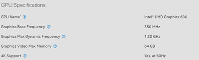

yes 7-10th do use differnet drivers.  but 10th gen is on supported list which is the same driver im using. so my device should be supported.  its using the same 630 gpu.
example
i9-10900K Processor
https://www.intel.com/content/www/us/en/products/sku/199332/intel-core-i910900k-processor-20m-cache-up-to-5-30-ghz/specifications.html
