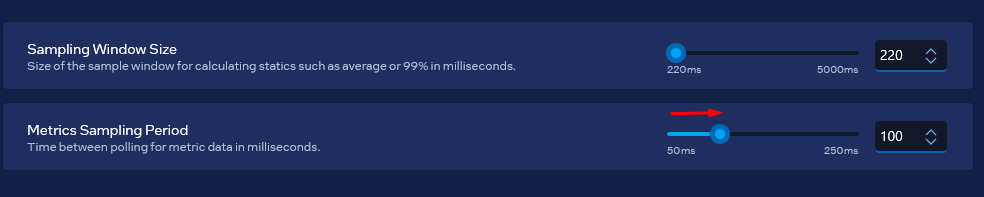

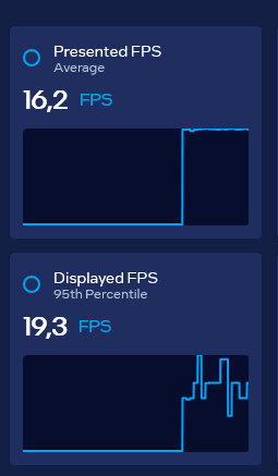

I now have another question about displaying FPS in monitoring
1 screen - when polling once every 50 ms >>> 2 screen - the displayed FPS is incorrect.
but it changes if you change the polling time 3 screen >>> 4 screen

I'm glad to hear that your initial issue was resolved with the new driver update. To clarify the difference in FPS metrics: the 95th percentile FPS represents the frame rate achieved or exceeded by 95% of the frames during gameplay or benchmarking, meaning only the slowest 5% of frames fall below this value. In contrast, the presented FPS is the frame rate displayed to the user, which may be influenced by the game engine or display settings. This metric might not always accurately reflect the true underlying frame rate due to factors such as frame rate capping or variable rendering times.
Additionally, the reason the value changes when you adjust the polling is that you're setting the frequency at which the presented FPS is updated. This means the displayed frame rate is influenced by the polling interval you choose. Please let me know if you need further clarification on this.

The problem is that it is impossible to configure IGS to correctly display FPS, regardless of what I choose, "average", "maximum" or other parameters!
