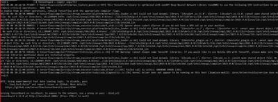

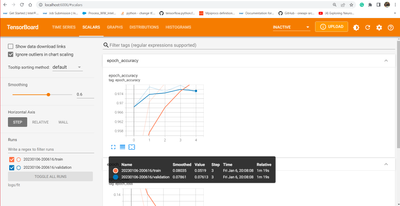

Thanks for posting in intel communities.
We tried from our end and we are are not getting any segmentation fault. We installed WSL in our system (supported 10th generation processor) & tried on ubuntu 20.04 and created python environment & tried some ML models and we are able to generate output in a form of a log file on Tensorboard.
We assume that you are using latest processor with older version of Intel distribution for python 3.9.12 because of that you are getting segmentation fault. We suggest you to upgrade your Intel distribution python with latest version and try again. After that If you will face any issue please let us know.
You can see the below screenshots.
