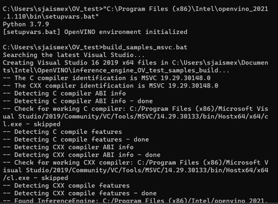

Generally,
there are two CMakelist.txt involved when compiling OpenVINO C++ in Windows Runtime(I created a new dir named test):
  1. OVpath\samples\cpp\CMakeLists.txt
  2. OVpath\samples\cpp\object_detection_sample_ssd\CMakeLists.txt
I'll leave CMAkeList file at number 1 as it is and edit number 2.
Then, I built it
The binary is generated without error.
Cordially,
Iffa

Iffa_Intel
4,680 Views
Same concept applies if you change your dir.
Required files/folder: common, thirdparty, build_samples_msvc.bat,CMakeLists.txt
I created test2 folder with the same content as I've shown before with its CMakelist
Init setupvars beforehand & compile:
Success Compilation:
Binary produced:
Cordially,
Iffa

Iffa_Intel
4,581 Views
I hope you noticed that there are 2 CMakeList files.
Please use the original CMakeList without changes in the main folder, mine is in C:\Users\sjaismex\OV_test
The only changeable CMakeList is in your custom (newly created folder), mine is in C:\Users\sjaismex\OV_test\test2:
Run the setupvars.bat before doing any compilation/build or inferencing.
If you've done this properly as mentioned and your custom inferencing code has no problem, there shouldn't be issue with the setup files/linker.
Cordially,
Iffa
