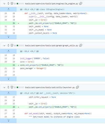

It is recommended to use  Neural Network Compression Framework (NNCF) post-training quantization. You may refer to the release notes for the latest update of OpenVINO.
However, it seems like the POT usage on Windows platform is a known issue caused by accessing the same files in read and write modes. Refer to this Known Issues. You may try following this guide to disable the default switch to the MMap allocator. The issue is fixed for POT quantization on Windows, see the PR in the OpenVINO repository for more information.
Hope this helps.

Hello Aznie,
Thanks I managed to find the files and add in the workaround.
But seems like I am still getting the same error messages... any idea?

Hello Aznie,
I saw the workaround is stated as
  • Weights mapping - memory mapping (using mmap) has been introduced as the default way to work with weights. Currently, this feature is supported by the IR frontend. Mapping may be switched by specifying the ov::enable_mmap(BOOL) property for the ov::Core. Because of its “memory-on-demand” nature, there is no need to store all weights in RAM. Storing just the data that is needed at the moment lowers the amount of memory required for compilation. Moreover, mmap provides extensive memory sharing, so the consecutive compilation of the same model will fetch the information already stored in RAM instead of reading it one more time from storage.
By the way I look at the github fix but I dont seems to be able to find the files location
Right now I am running pot.exe function from openvino_env\Scripts\pot.exe
May I know where i can locate these files?
tools/pot/openvino/tools/pot/engines/ie_engine.py
tools/pot/openvino/tools/pot/graph/graph_utils.py
tools/pot/openvino/tools/pot/utils/launcher.py
Aznie_Intel
4,746 Views
Hi DarkHorse,
You may find the files in your pot directory: <path-to-venv>Lib\site-packages\openvino\tools\pot\graph. All files are available in your pot directory. If you are installing OpenVINO from PyPI, your OpenVINO directory is depends to your Python location: <path-to-venv>/site-packages/openvino.
