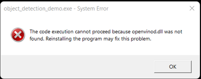

I am trying to run the "Object Detection C++ Demo" (https://docs.openvino.ai/2021.4/omz_demos_object_detection_demo_cpp.html).
In the process, I encountered errors when executing [build_demos_msvc.bat VS2019].
These are the steps I executed:
  1. "pip uninstall openvino-dev": I ran this thinking this openvino version  for Python will conflict with the offline/online runtime installer version, I want to run for C++ programs.
  2. Downloaded and installed the offline/online runtime installer. All good in this step.
  3. Executed "setupvars.bat" successfully and "build_demos_msvc.bat" with errors, as follows:
<PATH>\open_model_zoo\demos>"C:\Program Files (x86)\Intel\openvino_2022.1.0.643\setupvars.bat"
Python 3.9.13
[setupvars.bat] OpenVINO environment initialized
<PATH>\open_model_zoo\demos>build_demos_msvc.bat
Searching for the latest Visual Studio...
The most recent version of Visual Studio installed on this computer (2022) is not supported by this script.
If one of the supported versions is installed, try to pass an argument to this script to indicate which version should be used.
Supported versions: VS2015 VS2017 VS2019
Error
<PATH>\open_model_zoo\demos>build_demos_msvc.bat VS2019
Creating Visual Studio 16 2019 Win32 files in C:\Users\manue\Documents\Intel\OpenVINO\omz_demos_build...
-- Selecting Windows SDK version 10.0.19041.0 to target Windows 10.0.22000.
-- The C compiler identification is MSVC 19.29.30145.0
-- The CXX compiler identification is MSVC 19.29.30145.0
-- Detecting C compiler ABI info
-- Detecting C compiler ABI info - done
-- Check for working C compiler: C:/Program Files (x86)/Microsoft Visual Studio/2019/Community/VC/Tools/MSVC/14.29.30133/bin/Hostx64/x86/cl.ex
e - skipped
-- Detecting C compile features
-- Detecting C compile features - done
-- Detecting CXX compiler ABI info
-- Detecting CXX compiler ABI info - done
-- Check for working CXX compiler: C:/Program Files (x86)/Microsoft Visual Studio/2019/Community/VC/Tools/MSVC/14.29.30133/bin/Hostx64/x86/cl.
exe - skipped
-- Detecting CXX compile features
-- Detecting CXX compile features - done
CMake Error at CMakeLists.txt:44 (message):
  Only 64-bit supported on Windows
-- Configuring incomplete, errors occurred!
See also "C:/Users/manue/Documents/Intel/OpenVINO/omz_demos_build/CMakeFiles/CMakeOutput.log".
###############|| Build Open Model Zoo Demos using MS Visual Studio ||###############
cmake --build . --config Release
Microsoft (R) Build Engine version 16.11.2+f32259642 for .NET Framework
Copyright (C) Microsoft Corporation. All rights reserved.
MSBUILD : error MSB1009: Project file does not exist.
Switch: ALL_BUILD.vcxproj
Error
 I have VS2022 (which I understood is not supported) and VS2019 v16.11.15 (which is supported).
Please help me fix the error above.

I got the Only 64-bit supported on Windows” error after executing the "build_demos_msvc.bat VS2019" at the command prompt. How can I call VS2019 x64 executing the same batch file at the command prompt? Or, am I missing a setting or a step?
RGVGreatCoder
2,730 Views
I decided that, instead of executing "build_demos_msvc.bat VS2019"  at the command prompt, I make use of "CMake" mentioned on this page (https://docs.openvino.ai/2022.1/omz_demos.html#build-the-demo-applications).
These are the steps I performed:

At this point, I can't tell if there were any issues but if there were, please let me know.
Following, I executed "cmake --build . --config Release --target object_detection_demo" and noticed all the errors that appeared occurred on "...cpp\models\models.vcxproj":
C:\Users\manue\source\repos\AI-Machine-Learning\omzoo_odcpp_demo>cmake --build . --config Release --target object_detection_demo

However, when I double-clicked the "object_detection_demo.exe" files in either folder, I get this error:
Questions:
  1. Did I do wrong copying the content of the "gflags" folder in "open_model_zoo_2021" to "open_model_zoo_2022"?
  2. Why am I getting that System Error message if I installed OpenVINO 2022.1.0 runtime/offline installer and I also ran "pip install openvino-dev[onnx,tensorflow2]" (this one because I want the extra developer tools)? What am I missing?
  3. How can I run the "open_detection_demo c++" from within VS2019 (I will appreciate detailed steps as possible) in "Debug" mode to see how to code works?
Thank you and will be waiting for your reply,
Manuel Hernandez

I deleted the "open_model_zoo" folder and the "omzoo_odcpp_demo" folder to redo the steps again. This time, I git cloned the "open_model_zoo" and ran git module update, then "CMake" before building the projects in Visual Studio 2019. All went smooth and with no errors. However, when I doubled clicked "object_detection_demo.exe" inside [C:\Users\manue\source\repos\AI-Machine-Learning\omzoo_demos\intel64\Release] folder, I got a System Error that read:
"The code execution cannot proceed because openvino.dll was not found. Reinstalling the program may fix this problem."

However, when I double-clicked the "object_detection_demo.exe" in the "Release" folder, I get this error:
Questions:
  1. Why am I getting that System Error message if I installed OpenVINO 2022.1.0 runtime/offline installer and I also ran "pip install openvino-dev[onnx,tensorflow2]" (this one because I want the extra developer tools)? What am I missing?
  2. How can I run (debug) the "object_detection_demo c++" project in Visual Studio 2019 in such a way I can set breakpoints in the source code to learn how it works (I will really appreciate detailed steps)?

Hi RGVGreatCoder,
Thanks for your patience. We've got reply from the relevant team.
The error seems to be from the Microsoft Visual Studio and not from OpenVINO™ toolkit. Let's focus on using build_demos_msvc.bat VS2019 and the system is Windows 10. Make sure to run the Command Prompt and select "Run as administrator " because the path directory is not accessible by Microsoft Visual Studio. If the issue still happens, please re-install the Microsoft Visual Studio 2019 based on the configuration here.
Hope this information help.
Wan
