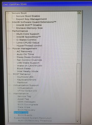

jasonsloan
5,461 Views
Thanks Zulkifli!
When I tried to fix it with your first suggestion, I couldnt find the setting you mentioned, and the complete bios setting of my computer is below:
Zulkifli_Intel
5,436 Views
Hi jasonsloan.
You can go to Video and then select Intel HD Graphic.
For your information, there was a similar issue in the compute-runtime GitHub page where the user also received "clinfo Number of platforms 0". This issue was resolved by adding the user to the "render" group. You can try this method to see if this solves the clinfo issue.
On the other hand, can you please try to install the apt packages below:
apt-get install -y ocl-icd-libopencl1 intel-opencl-icd intel-level-zero-gpu level-zero
Zulkifli
