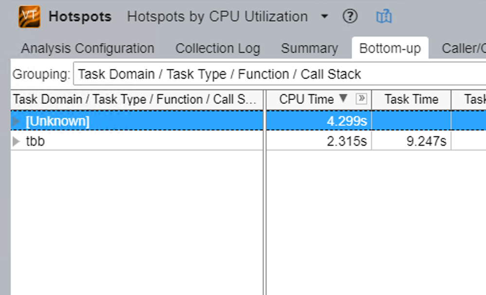

Has anyone been able to get openvino to play well with vtune on Windows? When running there I don't get any tasks from the Inference engine or MKLDNN.
I do get tasks from TBB so the eventing is working but it looks like the windows 2020.2 build might have even built without the ITT libs.
The linux builds are fine and give the expected instrumentation events.

Hi RJ,
are you trying to see which functions are being used inside Inference Engine and MKLDNN Plugin? Have you tried to view the result in "Module/Function/Call Stack" grouping?
