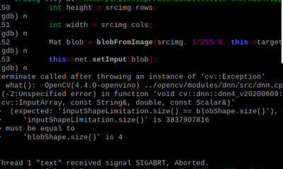

I tried to make a program about FaceMask-Detection.Before,my programme could run successfully with the caffe model.However,When I turn caffe to ir model,it has problems as follows.
gdb debug:
i guess the problem is model'format.but i cant sovle it
pls help me.

Hi AyasaYasca,
I noticed that the error you encountered:
“'inputShapeLimitation.size()' is 2 must be equal to 'blobShape.size()' is 4”
was due to incompatible sizes used which related to the blob size. You may refer to here for more information.
