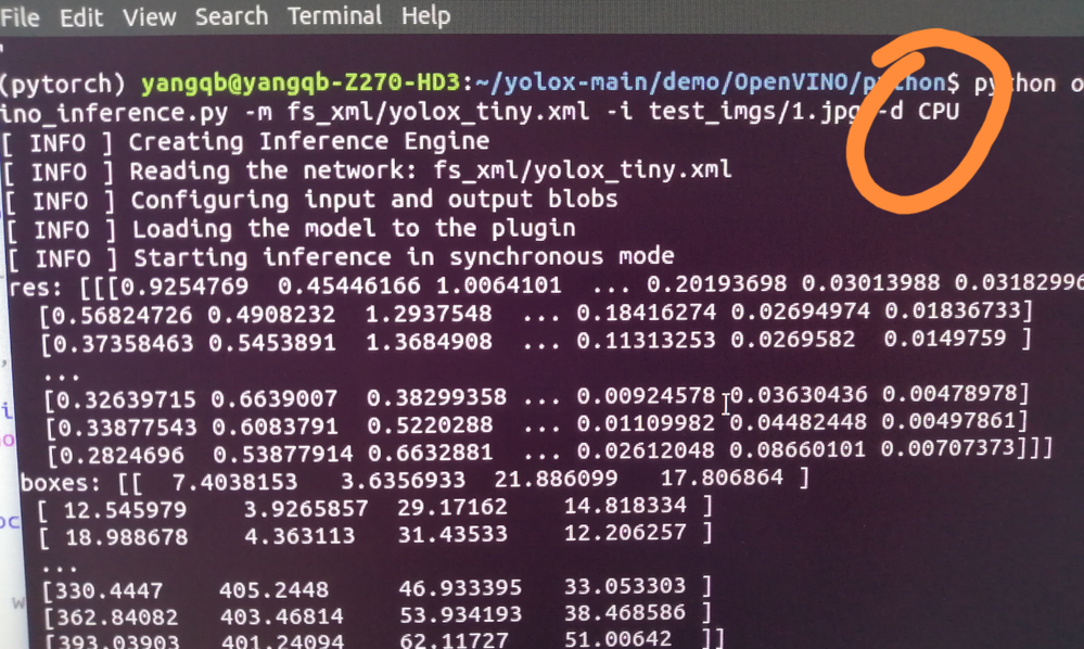

I have trained a yolox for object detection and successfully converted yolox model -> onnx -> IR <Openvino format>. The inference results from cpu were right, while the inference results from myraid were wrong, and I found numbers in myriad results were all integers.
Kindly help me resolving the issue. Thanks
