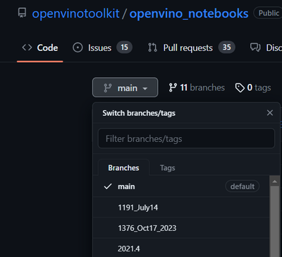

The current Master branch would be the "main" branch.
Running the default git clone command should get you the main branch:
git clone --depth=1 https://github.com/openvinotoolkit/openvino_notebooks.git
Hairul
