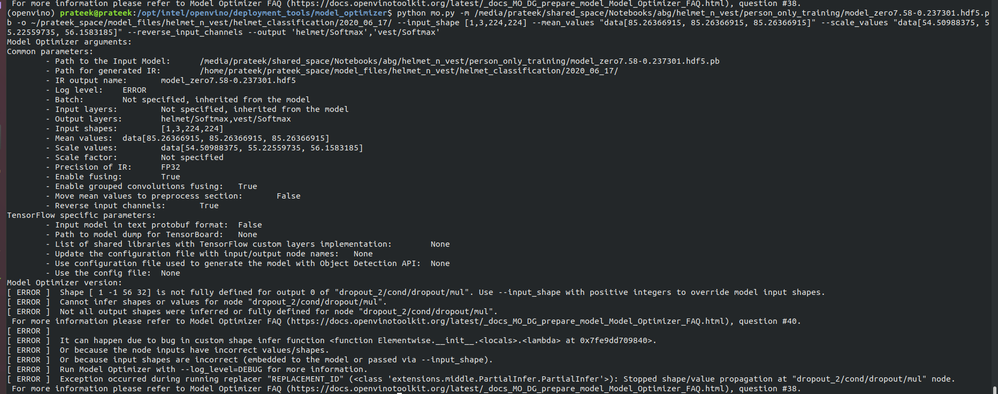

hello,
i trained model in keras,
model has one input and two output
I have converted h5 to pb by using script available https://software.intel.com/en-us/forums/intel-distribution-of-openvino-toolkit/topic/820599
I use following command to convert model
python mo.py -m /media/prateek/shared_space/Notebooks/abg/helmet_n_vest/person_only_training/model_zero7.58-0.237301.hdf5.pb -o ~/prateek_space/model_files/helmet_n_vest/helmet_classification/2020_06_17/ --input_shape [1,3,224,224] --mean_values "data[85.26366915, 85.26366915, 85.26366915]" --scale_values "data[54.50988375, 55.22559735, 56.1583185]" --reverse_input_channels --output 'helmet/Softmax','vest/Softmax'
Sahira_Intel
1,938 Views
Hi Prateek,
First, thank you for your patience while we resolved this.
It looks like the input size should be --input_size[1,224224,3]. You can also specify the batch size by using the parameter "-b" instead of specifying the full input shape.
Also, the name of the input node in the attached model is not "data" but "main_input".
I hope this is helpful.
Sahira

Sahira_Intel
1,939 Views
Hi Prateek,
Sahira
