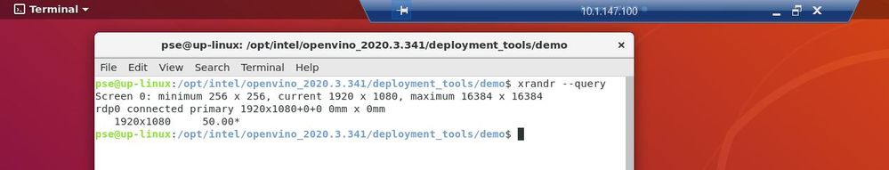

have installed XRDP on Up2 board running Ubuntu 16.04 and my acceleration on the GPU works fine when  a display is connected and run it locally. It also works fine when I run it remotely so long as a monitor is connected. Once the monitor is disconnected (and reboot) I get
self.exec_net = self.ie.load_network(network=self.net,device_name=self.plugin)
File "ie_api.pyx", line 178, in
openvino.inference_engine.ie_api.IECore.load_network
File "ie_api.pyx", line 187, in
RuntimeError: Failed to create plugin
/opt/intel/openvino_2020.3.194/deployment_tools/inference_engine/lib/intel64/libclDNNPlugin.so
for device GPU
Please, check your environment
[CLDNN ERROR]. clGetPlatformIDs error -1001
Is the GPU being disabled when no monitor is detected? if so, how can I get around this issue?
p.s. tried Ghost emulator fake display dongle available at Amazon. Did not help... Also tried remote via VNC and here could not even connect remotely when no display...

There are several things to check and troubleshoot regarding the encountered error: [CLDNN ERROR]. clGetPlatformIDs error -1001. You may refer to Driver issues troubleshooting.
You can check whether iGPU is enabled or disabled when the monitor is disconnected with the command below:
cat /sys/devices/pci0000\:00/0000\:00\:02.0/enable
In a meanwhile, how’s about connecting to a monitor and running with GPU in the beginning before disconnecting the monitor and without reboot?

We’ve replicated the issue by using our host machine (OpenVINO™ 2020.3.394, Ubuntu 18.04, Atom x7E3950, Intel® HD Graphics 505) and able to launch the security barrier demo with GPU as per below steps:
1)    Validate the screen connection - only rdp0 detected
xrdp.jfif
2)    Run security barrier demo with GPU - able to execute successfully
Demo.jfif
With this, we would suggest you try with the following ways:
1) Migrate to Ubuntu 18.04 - as Ubuntu 16.x is excluded from officially supported OSes for OpenVINO™ and running with different kernels, this might contribute the potential issues as reported.
2) Use substitute apps (MobaXterm or VNC) for monitor-less system access.
