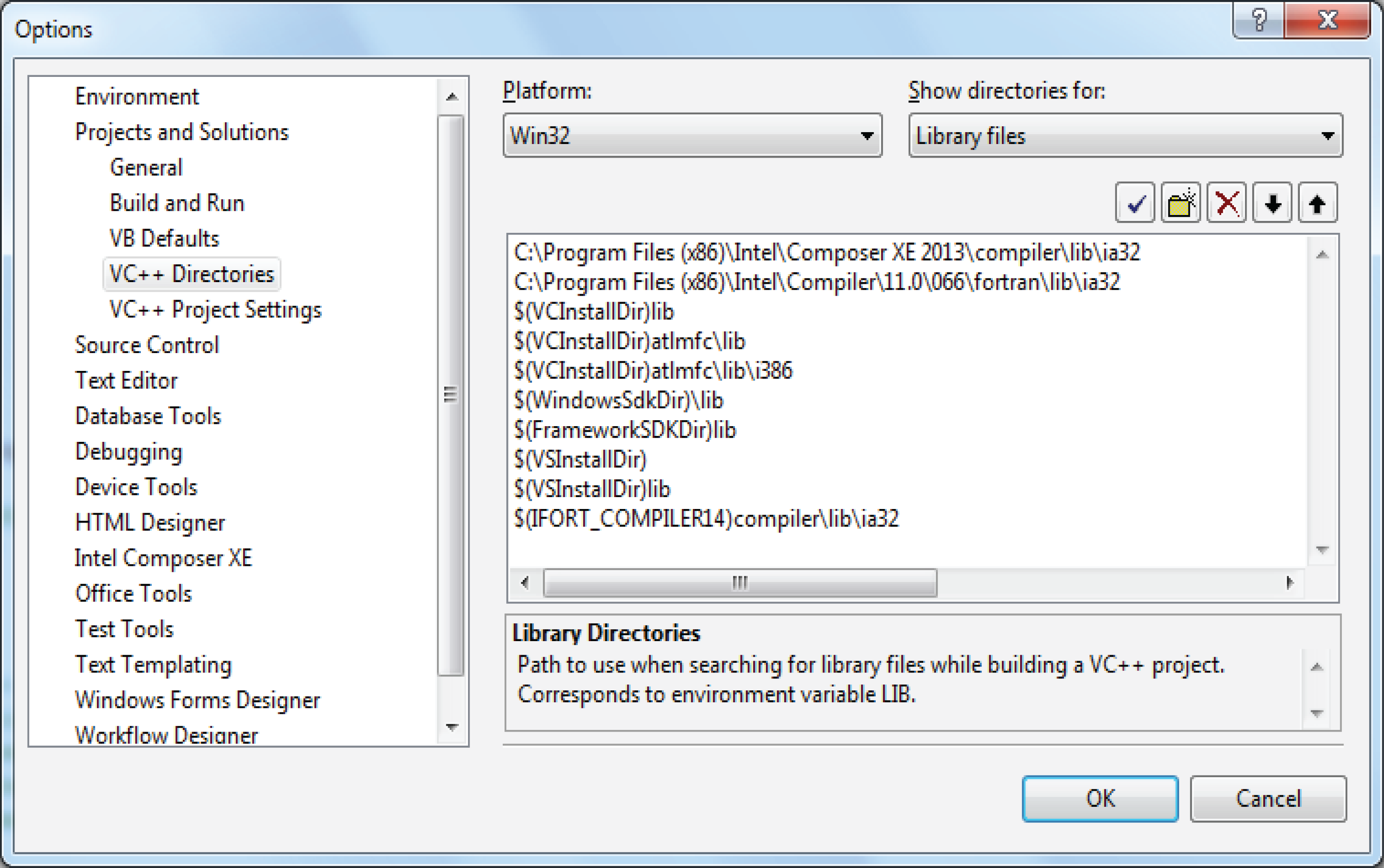

Hi, the mixed C++ and Fortran code has this link problem. When I mannually add the path of ifconsol.lib, the error disappears, but other link errors pop up, for example, error LNK2019:unresolved external symbol, which means it cannot link to other files, although we has already setup the linkage of all the files together through 'Project dependences' in the MS Visual Studio. Then after I manually added all the library files in the linker, the code ran well. The software packages I use are MS Visual Studio 2008, Intel Visual Fortran w_fcompxe_2013.3.171, and Intel C++ Composer XE 2013 SP1 w_ccompxe_2013_sp1.1.139. Does anyone know the reasons of those link errors? Thanks!
Have you followed the instructions in How do I configure Microsoft Visual C++ for developing mixed Fortran-C applications?
I followed the instructions, but the same error (cannot open ifconsol.lib) came out.
Show me a screenshot of the same screen as this one:
Note that in your case you will want IFORT_COMPILER14 there.
I see that the first two entries in the libraries list are for older versions of Intel Fortran. Take out those entries. But I see you also have 19 warnings. Can you attach the full build log (it will be a .htm file)? ZIP it first.
Does C:\Program Files (x86)\Intel\Composer XE 2013 SP1\compiler\lib\ia32 exist on your PC? Does it contain those libraries?
Because I tried IFORT_COMPILER14 first, it didn't work. You can see the 19th warning in the attachment. Then I found the file ia32.lib in the path C:\Program Files(x86)\Intel\Composer XE 2013 SP1\compiler\lib\, which I thought it should be same as IFORT_COMPILER14. Then I added this path, but it seems still not work.

It doesn't look as if you have Composer XE 2013 SP1 installed. You may no longer have the previous version installed either.

You don't have the SP1 version of Fortran installed, so IFORT_COMPILER13 would be the right choice. That should work. In recent versions of Visual Studio (2010 and later), project dependencies from C++ to Fortran don't work (this is a Microsoft restriction.)
Thanks for your comments.I installed Fortran SP1 version. $(IFORT_COMPILER14)compiler\lib\ia32 works if I manually add its related lib folder in the project linker. However, if I add it in Visual Studio 2008->tools->Options->Projects and Solutions->VC++ Directions->Library files, it cann't work.
Also the project dependencies from C++ to Fortran work well with this Fortran SP1 version and Visual Studio 2008.
I know it works because I've done it that way for years. I am not sure why it is not working for you, but I'm glad you have a solution. Yes, using project dependencies works in VS2008. It stops working in VS2010.
