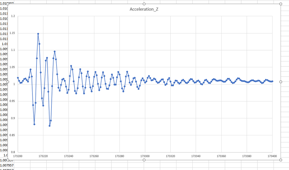

I was in a shopping mall a few weeks ago, on the upper floor, 2nd floor in USA and 1st floor in UK.  I could feel a strange movement in the floor.  It passed quickly and it occurred irregularly - say 20 times in 2 hours.  This conversation started me thinking about the floor movement, maxima, minima and resolution and how to tell if two numbers are the "same" .
So yesterday,  I went a spent an hour sitting in the food court, where I felt the movement strongly and recorded the data using an accelerometer.
I have a new program to determine the damping for structures, in Fortran of course.  So I collected this data to review the program algorithm.  It is challenging data.
-0.0191710107770644 g.
This is the typical acceleration number that comes from the machine.  We have a few limits, the first is the step resolution, about 0.3 microg. Easy to find from a plot of the data sorted.  We often have a problem with published papers when a theoretical engineer asks why the data is not smooth.  One guy said it looked like a saw tooth.  You cannot laugh because they are serious.
The second resolution is the thermal noise, 0.3 millig, you can see that at the end of the picture.
The interesting problem is the pulse shows up in the data.
The pulse is obvious,  this picture is one tenth of a second, so the pulse lasts a 20th of a second.  The large element is about a 200th of a second.
This thing has a range of about 0.2 g.  About 100,000 times the resolution.   So the first question is setting the data limits for the damping analysis.  The second is the standard damping model assumes that you use the natural frequency, but here we have a device that is driving the structure - a saw toothed pattern will play hell with the FFT.  THe FFT is going to be really short.  All numerical problems.

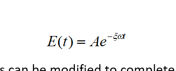

The interesting challenge is fitting the standard damping model to the data.  The asymmetry comes I suspect from the generator of the load not being balanced, like car tyres, but without the lead weights.
The interesting element  is the constant in the exponential time element, we can measure that reasonably and it we measure it over months, we will get a good idea of the statistical data, the number gives a representation of the energy decay,  moving to determine the damping factor as a % is the real question.
