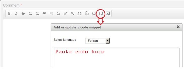

The (...) code button in the new-comment dialog summons a text box with language-specific formatting, and you simply paste in code directly from the VS editor:
