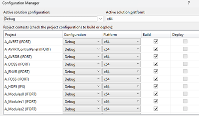

well, now that I can run the debug version of this code, I'm having some issues setting breakpoints in the debugger--I can click on the line on which I'm trying to set a break and the red, filled in circle appears (F9 also does this) ... however, when I attempt to run the program in the debugger, it seems to skip all of the breakpoints and (attempts to) run to the end--is there some 'setting' that I need to use to have it recognize breakpoints? sorry--I have used VS before, but not recently ... thanks (again)
Joe
jimdempseyatthecove
10,178 Views
Check the Configuration Manager and assure that the Build check box is checked for the configuration you are building. If it is not, you may be linking an older version of an object file into the executable.
Jim Dempsey
Steve_Lionel
10,324 Views
This is a debug build?  Is this just an executable, or a DLL that is called from something else? Please show a screenshot of the entire VS window with the breakpoint visible.
