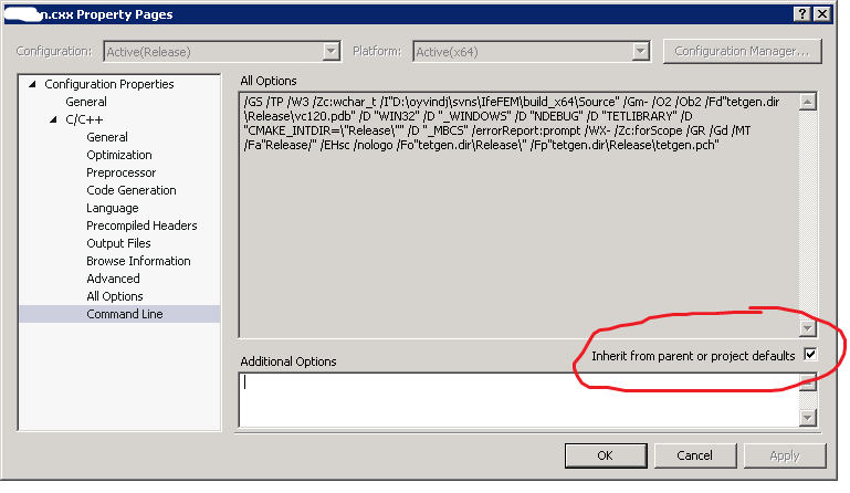

Sorry, I'll explain what I mean more clearly. I have attached a fortran project and a C++ project to demonstrate the missing feature.
In the .vfproj file you'll see that the project has an item which reads AdditionalOptions="/dummy_option1", and the source file has the item  AdditionalOptions="/dummy_option2". When I compile the project, it is only the source file specific flag "/dummy_option2" which is used. What I am requesting is that the AdditionalOptions of the source file should be appended to the AdditionalOptions of the project. The file would then be compiled with both flags: "/dummy_option1 /dummy_option2".
The feature I am requesting is available for C/C++ projects. In the attached C++ project you'll see that the AdditionalOptions of the source file are combined with the project's AdditionalOptions, so that both are used during compilation. In the IDE, there is a tick box that allows you to either replace or extend inherited AdditionalOptions.
Here is a use case where the feature would be very useful: You have a large project with lots of source files, and some of them have specialized compile flags listed in the AdditionalOptions field. If you then want to add a project wide flag to the AdditionalOptions field, you have to manually go through all source files that have specialized AdditionalOptions fields. This is cumbersome and error prone. On the other hand, if AdditionalOptions were handled as it is in C/C++ projects, you could just add the flag to the project's AdditionalOptions, and it would propagate to all files. (Except if you deliberately disabled inheritance for a certain file by unchecking the tick box.)

This screenshot displays the properties dialog of a C++ project, and I have highlighted the feature I am requesting.
