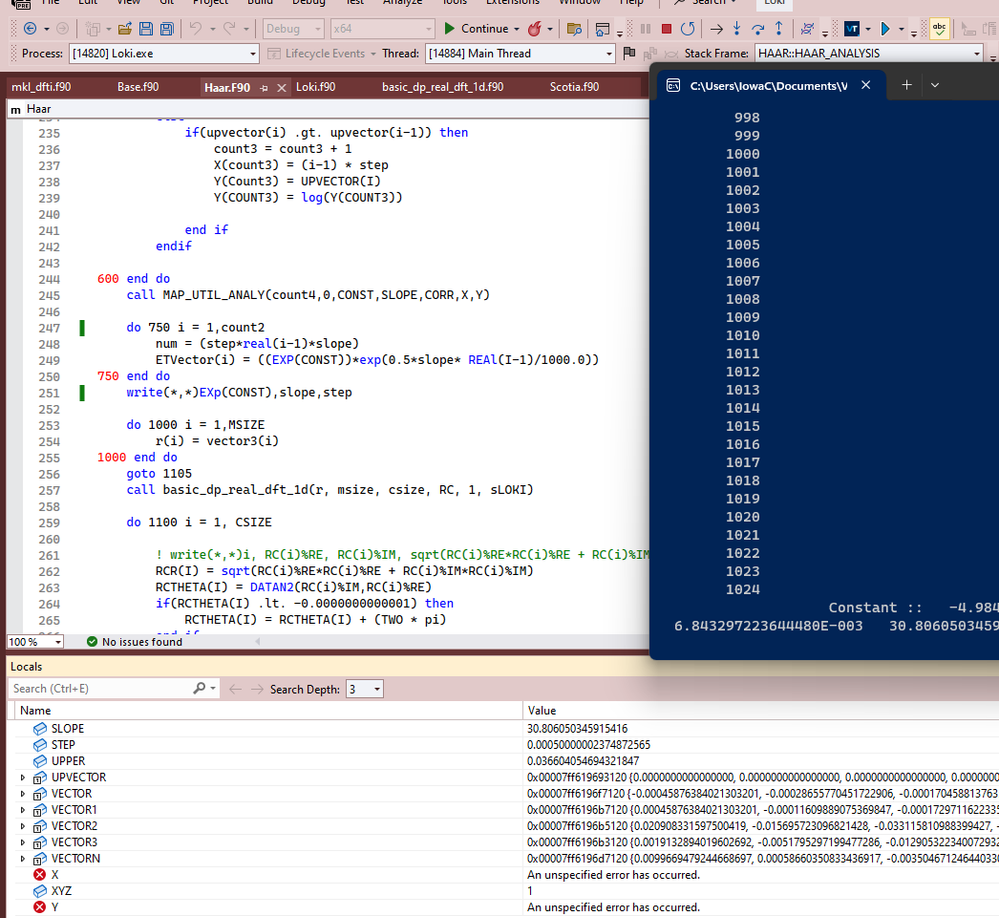

This works,
This does not for R, allocated
More of the same

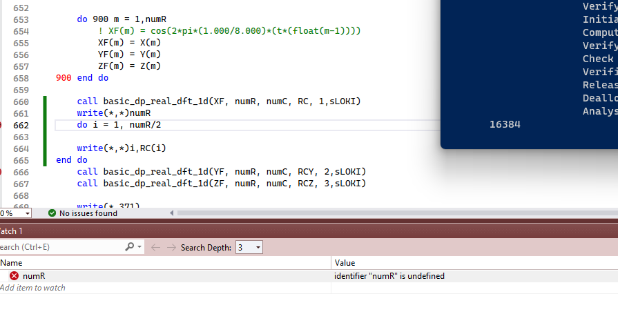

numR is 16384, which is a mistake as it is supposed to be a power of 2 and that is not, but it is definitely defined.
dum is an integer and is defined and I can see it in the code.
Any idea when we can expect a fix. DISLIN works with IFX but not really well with IFORT, so I do not want to go back.
I am using the old FORTRAN expedient of write(*,*) dum

1. "numR is 16384, which is a mistake as it is supposed to be a power of 2 and that is not, but it is definitely defined."
-- What? 16384 = 2^14
2. With declarations such as
character*100 name
statements such as
name = trim(name)
serve no useful purpose, since the expression on the right of '=', after trimming, is padded at the right with enough spaces to make the resulting string have the declared length of the variable on the left of '='.
3. I do not understand what you are reporting with all those screen shots. and what you mean by "works" or "does not work". Hopefully, somebody at Intel does.
4. In some of the Visual Studio local variable displays, I suspect some memory corruption because some of the numbers (with magnitudes below 1E-300) are implausible. For example, the value 1.581010066691989D-322 reported for FPI, written out in IEEE 64-bit hexadecimal form, is simply a single space character, Z'20'.

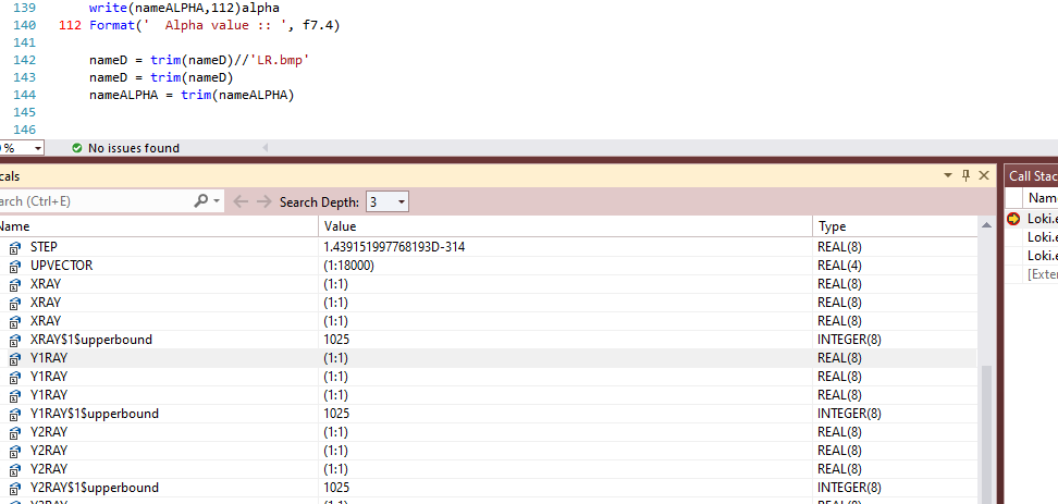

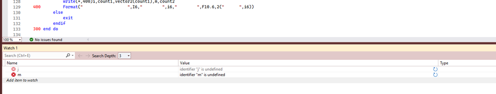

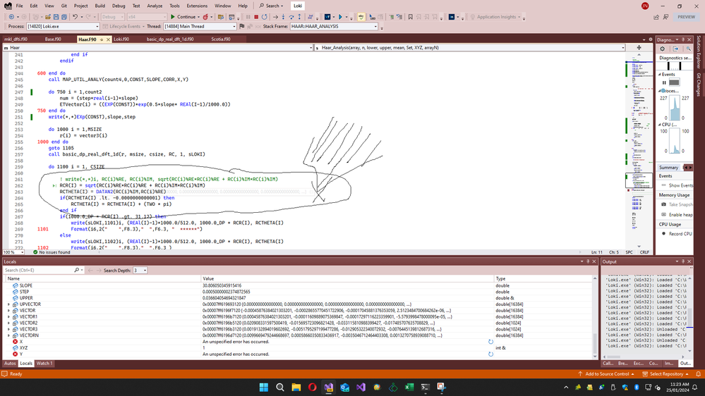

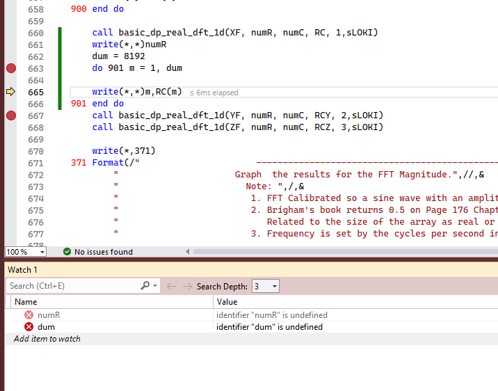

Problems:
1. Sometimes one can see the whole of the array in the debugger as in the first shot with R, you see each individual value, useful for debugging.
2. In the second picture the array shows say XRAY(1:1) and an upper bound, to see any value I need to go to the watch window and plug in XRAY[1000] == one at a time, it is very slow.
3. In the last shot the debugger says the variable is not defined and yet it can be seen on the screen and prints out. I did a dummy variable just to show the problem twice.

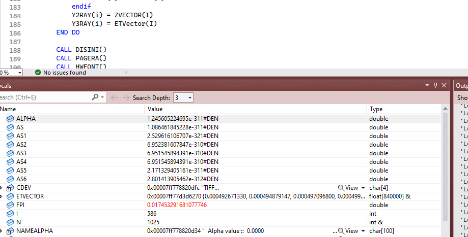

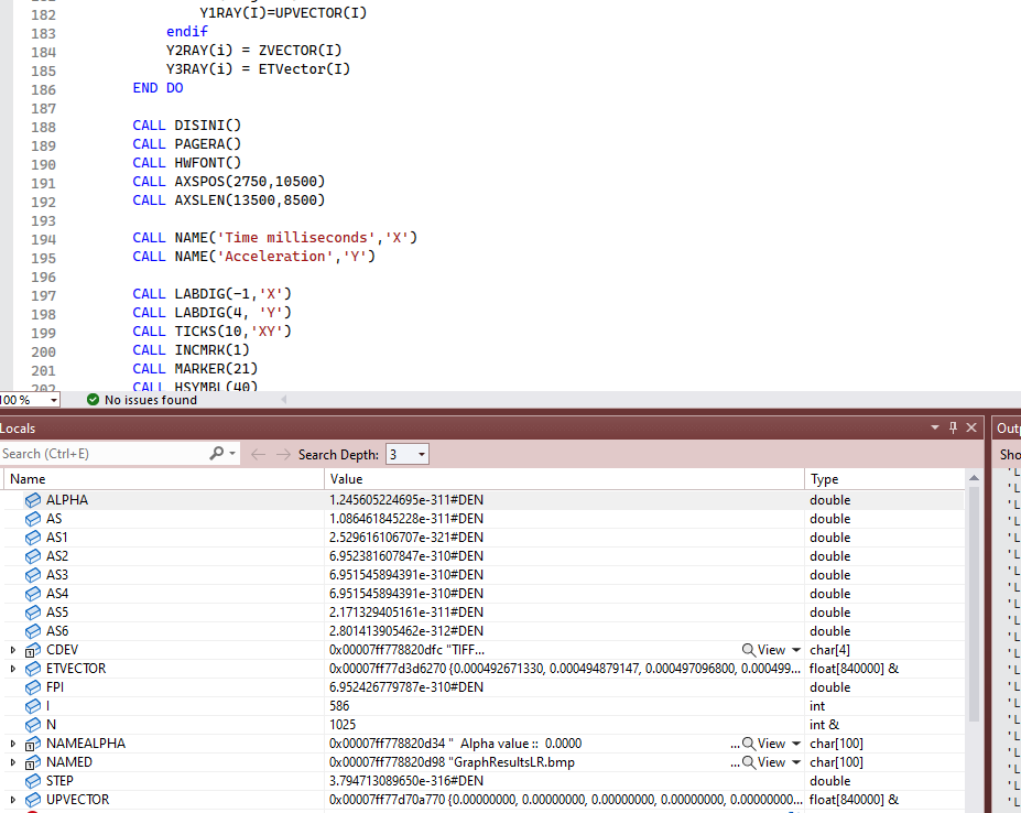

and on FPI as an unassigned variable,
In this screen shot FPI has been assigned but its value as for AS to AS6 values have not been set. So most use the standard code of 20 that has been discussed in much earlier posts, but AS5 does not and if it is not set the symbol #DEN is attached, no idea what #DEN stands for; perhaps Intel could tell us?
The ETVECTOR shows the new method of providing I presume a pointer to the array as the hexadecimal code first. That may be useful, but no idea why for the average user.
once a value for FPI is assigned it turns into a real number and the DEN disappears. looking at namealpha I see what you meant by the issue with trim as I used it.

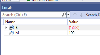

Bill Locals
Jane Locals
module Jill
contains
subroutine Jane(M, B)
integer :: M
! real :: B(M)
real :: B(:)
write(*,*) B(M)
!write(*,*) B(M+1)
end subroutine Jane
end module Jill
program fred
use Jill, only: Jane
real :: A(500)
a = 1.0
call bill(1, 100, A )
call Jane(100,A)
end program fred
subroutine bill(N, M, B)
integer :: N, M
real :: B(N:M)
write(*,*) B(M)
!write(*,*) B(M+1)
end subroutine bill
It would seem the IFX debugger integration only evaluates the array by default if you supply the array shape/size with an explicit interface as in subroutine Jane. In bill it has upper and lower bound identities (if you pass both) but only evaluates element one. This is quite different to IFORT and I would agree fully with John is a productivity problem with IFX. There are other issues with debugging in IFX that currently prevent me from using it other than for brief tests.

#DEN is an abbreviation for "denormal", i.e., a real number that is less in magnitude than the smallest number that can be represented with full precision -- 2.2251D-308 for double precision, IEEE representation Z'0010000000000000'.
There are some compiler options that allow you to control the treatment of such numbers, such as "denormals-are-zero", "flush-to-zero", etc.

Now DEN makes sense - thanks - I was once placed on an IEEE committee for metric and then removed as I was not an EE, but I was friends with the Committee Chair for a long time.
I took the simple step of setting all variables to zero at creation, saves a lot of messing about.
Although I always set them before use - even if they are zero.
The & symbol circled in red is telling one the variables that are passed as arguments of some form.
The watch window will not load integers.
It would be nice if the watch window listed parameters if asked, sometimes you forget a parameter in a module that you have not used for a long time.

@JohnNichols, can you attach a simple reproducer and explain what is not what you expect? The debugger team can't work with screen shots -- too many guesses about what your app really does.

John,
About 20 years ago I had a similar issue with an array showing up in the Debugger without the full dimensions.
The hack solution was to declare and define a pointer to the array (this can be in conditional code if you wish).
Now you could use ASSOCIATE. This may work for you.

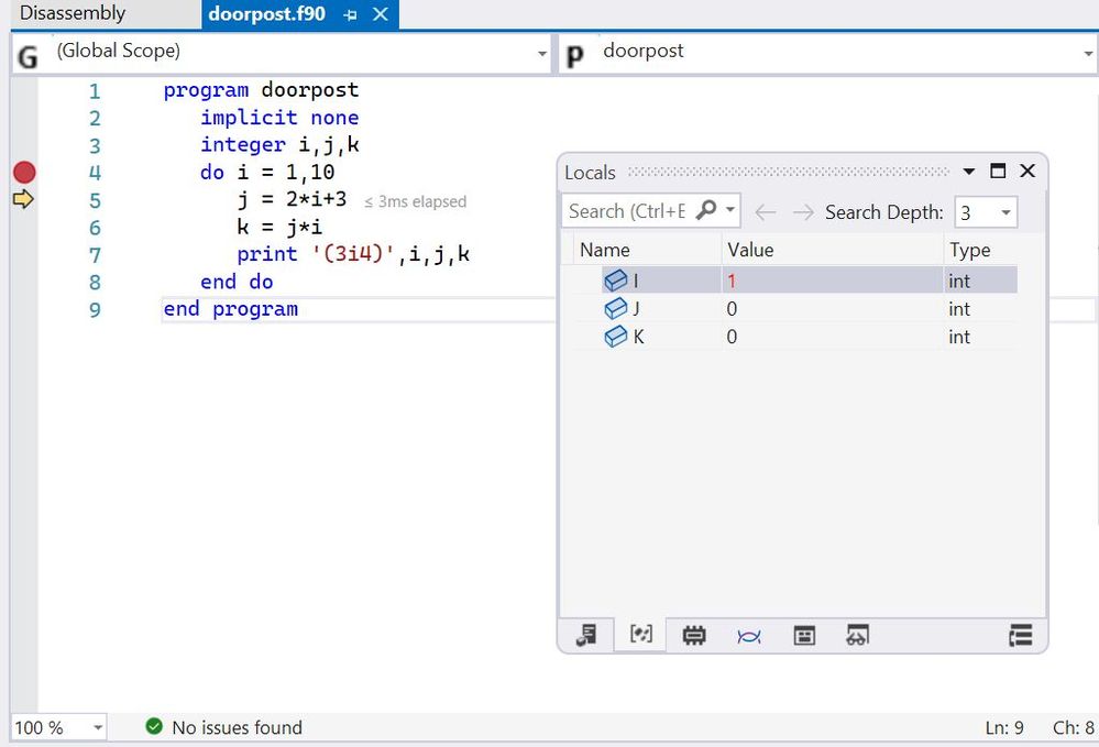

@JohnNichols, browsing through all the posts in this thread raised a doubt in my mind about how you were using the V.S. debugger and interpreting the contents of its numerous display windows, so I will express my suspicions in that regard.
Here is a screenshot of a trivial program, compiled with /Od /Zi, opened in VS. I placed a breakpoint on line 4, let the program run up to that breakpoint, and then executed one more statement, which placed the yellow arrow on line 5. This line has not yet been executed, so j and k have not yet been defined. However, line 4 has been executed, and that caused i to be defined with the value 1. I stress: the variables j and k have not yet been defined.
This state of affairs is not in agreement with what we see in the Locals window -- note the '0's displayed for j and k in the Locals window. Those '0's are garbage. Had more refined debugging options been used during compilation, the lines for j and k may well have said something such as 'undefined'.
I wish to stress that what is caused to be displayed in Locals and Watch windows, or by hovering the mouse pointer on a variable in a code window, etc., should not be taken literally without considering the current source line and knowing which source lines have already been executed. In a more complicated program, where control flow statements, subroutine calls and function references may be present as well, keeping track of which variable values displayed in a Locals or Watch window are valid is no trivial task, and it is easy to confuse oneself.

@mecej4 the display you show indicates that the Fortran debugging support is not being loaded - note the "int" for the type. It should look like this:

John, you also do not have the Fortran debugging feature installed/working - you're getting the default C support, which doesn't understand much Fortran stuff. In the past, what has generally worked has been to uninstall and reinstall Fortran. I will note your propensity to use "preview" versions of VS, in which case all bets are off.
