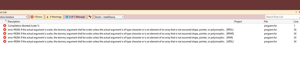

I downloaded the DOP853 code and the test program.  It has an interesting mix of code types,  there were four errors in compiling in VS 2019 with the IF 2021.1.2 - is the simplest way to fix the errors to get rid of the implicit reals and integers and go implicit none?

This has nothing to do with typing. Instead, it's passing a scalar to a dummy declared as an array. See the section on Sequence Association at Doctor Fortran in "I've Come Here For An Argument" - Doctor Fortran (stevelionel.com)
One workaround is to turn these scalars into array constructors, such as [RTOL]. This works as long as the subroutine doesn't write into the argument.

I got the problem running in IFORT.  Changed all to Implicit None and then fixed the RPAR(*) issues, appears to run and solve.
