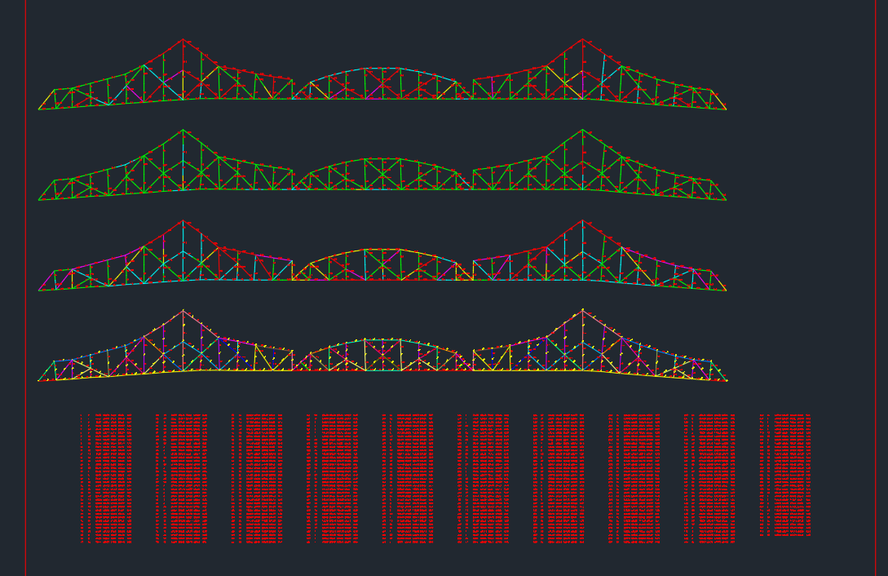

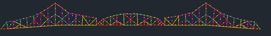

The actual plot is the following which you can give the client.  It is much better than a long EXCEL file or 50 GB.

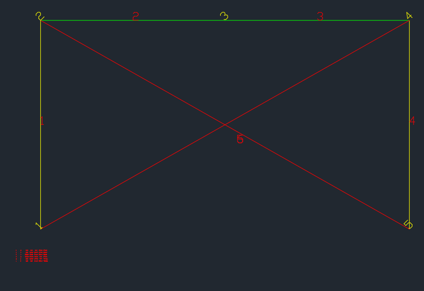

Harrison uses a single brace in one problem.  If you need to put a door in you have to use a single brace, as one of the chaps I knew found out the hard way.  But a single brace is not a good solution for cost and I would prefer not to have a brace in compression in an earthquake a recipe for dead people.
The secondary problem with AutoCAD is you need a large array, each element covering about 1 mm in size, when you occupy a space on the drawing you switch on the element, you then know not to put two items in the same place, above 5 and 6 were moved apart, but clearly incorrectly.
So we are exceedingly lucky to have such people.
