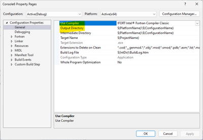

Those variables are defined by Visual Studio based on what you have specified in the solution and project properties. For example:
Remember that there are different Platforms whose settings are independently set, too.
ConfigurationName is typically Debug or Release, and is selected by you before you build the project. I didn't mean to highlight "User compiler" in that screenshot.
In other words, these variables are taken from project and solution properties.
