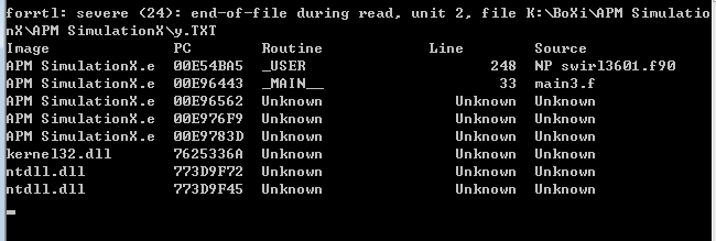

Hi Steve,
A breakpoint was triggered when I compiled the code.
The console window showed that "forrt1: severe <24>: end-of-file during read, unit2" (as attached image).
The code stopped at the place shown below
DO I=1,L1
  DO J=1,M1
     READ(2,"(1XE15.7)") yy
     ycor(I,J)=yy
  END DO
END DO                                                                                                                               ================================================
The code is fine for DVF, and the y.txt file has enough information for reading.
Is it the Syntax error for IVF?

There's no syntax error. Most likely is that the file y.TXT did not exist in the project folder where it is looked for by default. If you did an OPEN without STATUS='OLD', it would have created a new, empty file that then got an end-of-file on READ. This is exactly the same behavior as CVF/DVF.
Bo-Xi
993 Views
You are right!!! The .txt file is not under the folder from which the compiler loaded. Hence, an empty .txt file was created for reading. The error was fixed after I moved the correct .txt file to the folder.
