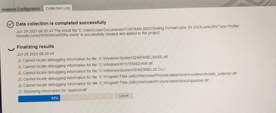

Now, as Hotspots is about to display the results, it flashes a screen that I could not capture with screenprt so I took a couple of snapshots with my phone:
and then a moment later
Do these give a clue as to what is going on?
