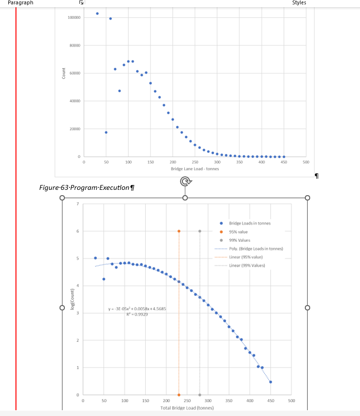

I wrote a traffic generation program to model 80 years of loads on a road bridge using log normal MKL -- the samples for MKL are painfully old and tattered. Anyway it uses a typical pattern and about 8 standard vehicles generated a few million times and I get this interesting pattern of the mass of vehicles on the bridge over time,
see below
I had explained to the client why I thought a simple Gaussian distribution of a single pattern would generate this shape if tested 10000 times, anyway the pattern is interesting, the A and the B are also interesting.
It is based on a 120 metre bridge and a 50 tonne standard semitrailer. The X axis is tonnes on the bridge - this is a single lane.

What is the Y axis?

Y axis is the total load on the bridge, I am just checking the math now as I write the report. I cannot see how it is correct, but it is interesting.

So the X axis is tonnes on the bridge and the Y axis load on the bridge??? Isn't that essentially the same dimensionality?

Jim:
Y axis is the count for the X axis load on the bridge.
I have played with the masses of the trucks and the limits on each category chosen from the log normal returns and made it into a normal look now. It was a combination of things that caused the shape, interesting really.
Log normal are not nice to play with, very sensitive to the seed value. I am looking for the 95% load, which is about 220 tonnes.
I did 1 million load alternatives and 100 million and they give the same result. I found the parabola in the log transformation interesting.

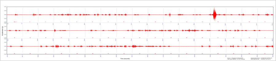

Bridge simulation (experienced guessing going on here) would exhibit some peculiarities not present in your charts.
Assume you have a 50T truck approaching an otherwise empty bridge. The bridge prior to truck entering the bridge is experiencing its static load (plus possibly environmental loads (wind, rain,...)).
When the front axles of the truck enters the bridge, its load transfers into the bridge, then some short time later the trailing axles enter the bridge and contribute their loads to the bridge.
An interesting aspect of this (which should be evident in your simulation) is that the load of the axle does not immediately affect the strain into the bridge. There are factors of inertia at play, and then momentum, and the rate at which the strain propagates from the entering end bridge to the exit end of the bridge. These factors will exhibit themselves as a vibration/bounce in the bridge.
Your markers A and B in the earlier charts might be a side effect of the simulation integration step size being in phase (or 180 degrees out of phase) of some internal tuning parameter. .OR. the configuration of the test reached a harmonic of the bridge.
You should be able to investigate this by changing some parameters and then observing the changes in behavior (to see if they confirm you guess as to the cause).

If we have a railway bridge the standard theory works, because the train and the carriages are heavy and solid, a small truck even 50t is not going to make a large movement in the bridge, often it does not out weigh the thermal motion. Bridges move a lot - you just cannot see it.
Acceleration wise the 14th reading is a truck, on the displacement, plotted so it fits and is a bit of a kludge, the acceleration is damped out effectively, now if I hit the bridge with a 400 tonne train - tandem at 800 tonnes and carriages with no separation, I am moving everything in a half mile radius as long as the ground is not stone.
