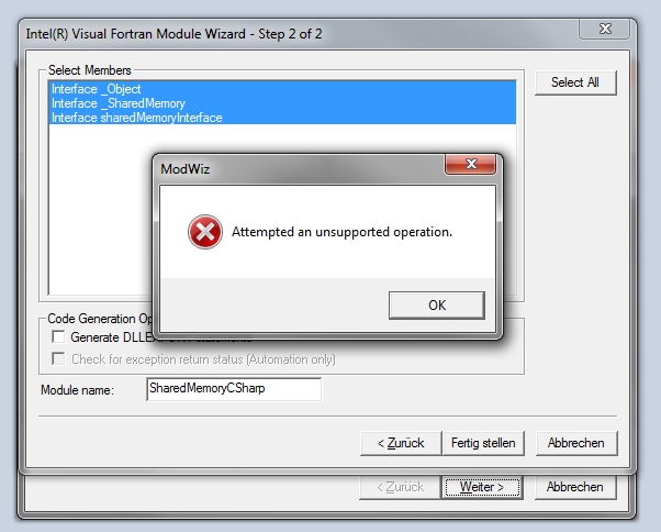

Hi there,
Im stuck with the module wizard. It gives me the same error message, "attempted an unsupported operation". It doesnt matter if I try it with the .NETDLL or with the Type Library, like anthonyrichards described.
I think its because Im still using IVF 11.0.075, which is not Windows7 certified (which I have right now in 64 Bit). Is this fixed in the actual XE compiler?

Edith wrote: I got it with using the good old CVF module wizardwith Windows7 ;-)

Markus, I doubt Windows 7 has anything specific to do with it. Can you attach the DLL or TLB you are using?

I can't reproduce a problem using Composer XE 2011 Update 7. Just to make sure I have this right, please list the exact steps through the Module Wizard that you take.
I recall seeing the error message you report complained about in 11.1 but I think it was fixed in 12.0.

Ive uploaded pictures where you can see, what happens.
Thanks for looking after this, but if it is an IVF 11.x bug, you cant do anything about it any more.

Ok - seems to be the same as what I tried and it worked fine in 12.1.
