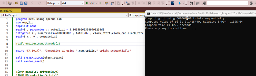

I have to turn off the num_threads to get it to compile, the linker throws an error.  This is on a dell precision that is working hard on two accelerometers at the same time.
Barbara_P_Intel
5,273 Views
@JohnNichols , did you compile with /Qopenmp? You need that for the !$OMP directives to be recognized, otherwise they are just comments. Also, need that compiler option to pull in the library that contains the routine, SET_OMP_NUM_THREADS.

I created a new Fortran program in VS 2022, added the code and followed what I thought was the manual instruction to add the -qopenmp.
I then placed the picture and knew someone would advise me of my mistake.
I tend to agree with Andrew the problem is to small to be useful.  I was using IFORT and WIN 32.
A two core machine is going to be doing other things, so I do not expect much change.
