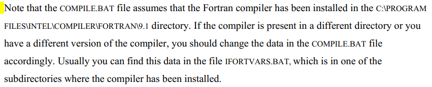

balint__schon
6,546 Views
Dear Csaba,
I have some problem with compile Cycle tempo subroutine. I have not the same problem as you have, but i am sure i will be able to help me. I am stoped at this step. I have no found this directory and compile command is not working.
I really appritiate your help!
Could you please let me now, if you are able te provide me some good advise.
Anyway, where are you from? Hungary maybe :) Just because if your answear is yes, we can comminicate with our mother language. We can talk via facebook. My whole name is Schön Bálint.
