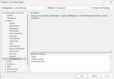

Programs compiled with ifx are slower than compiled with ifort. Is this going to change with the future updates? Speed is very important to me and now ifort has been discontinued.

Perhaps you can share the compiler options you used, and the Intel processor you are targeting with -x or -ax, and if you can, share the sources.
eliopoulos
4,453 Views
I don't know where to find the compiler options you need. I use two different Intel processors: core i9 14900ks and core i7 1260p. I don't understand the -x and -ax thing. I compile from the Visual Studio Community 2022. I don't want to share the program in public but I could send it with e-mail.

This is what I use:

Without knowing your compiler options, it's difficult to say what might be causing this.  I suggest you share the Fortran command line from the project properties.  For example,
One thing I noted, when we ported to ifx,  was that if you use /standard-semantics it degrades floating point performance significantly with IFX because it sets /assume:ieee_compares.  You could (like us) add /assume:noieee_compares as an additional option.

My compiler options:
I tried to add /assume:noieee_compares and the program remains slower than compiled with ifort.

Nothing obvious stands out here.  I'd suggest profiling your program with vTune to see where the hotspots are.

What you showed does not match the recommendation I had for using -x or -ax options.  This is called out in the Porting Guide
https://www.intel.com/content/www/us/en/developer/articles/guide/porting-guide-for-ifort-to-ifx.html
under the section on CPU performance:
-O2 Add -x<code> to enable all available Intel optimizations and advanced vectorization. Add -xHost to enable those optimizations the platform where you are compiling.
O2 is NOT enough for ifx.  It was for ifort.  With ifx, you only get Intel proprietary optimizations IF you include -xhost or -x<arch> or -ax equivalents.
This is something I am hearing from customers.  They got used to simply using O2 with ifort and are unaware that they have to use O2 and -x<something> with ifx.  I recommend -O2 -xhost.  Try that.

How can I set: -O2 -xhost?

O2 will be set by using Release Configuration.  Here is where to find setting /Qxhost

ifort remains 20-30% faster.
