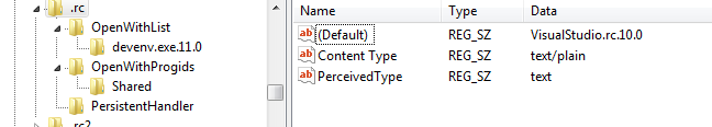

I've seen this happen when the file association for .rc files gets changed.
Run regedit.exe and look at HKEY_CLASSES_ROOT\.rc
You should see something similar to this (the VS versions will vary depending on what you have installed.)
If it doesn't say text/plain, that may be the problem. In this case I usually suggest deleting the .rc entry from the registry and doing a "repair" on Visual Studio.
That "Open with devenv.exe" worries me a bit. I suggest you delete the .rc entry and do a repair of Visual Studio - that should fix it.
