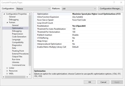

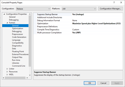

Hello everyone,
I want to do transposition for 60720x60720 matrix.
In project properties, I turned on Maximize Speed plus Higher Level Optimizations (/O3) and Yes (/Qparallel). I also chose the configuration is release x64.
But my program isn't optimized. Please kindly help me!

I am not sure it is possible to claim 100% of all CPUs. When I ran your program as is (well, after adding calls to cpu_time) on my Windows laptop, I got roughly 100% of one processor, that is 12% of the total (4 physical processors and hyperthreading enabled). I modified the program as attached to use OpenMP instead. The timings were:
  • Your program: 505 seconds wall clock, 475 seconds CPU.
  • My OpenMP program: 144 seconds wall clock, 627 seconds CPU, 60% of the total CPU, so roughly three times faster
I have attached the program, it is not optimised in any way other than using explicit loops and OpenMP. Transposing a very large matrix in this way has a very awkward memory access pattern. There are very probably much more efficient ways to do so.
