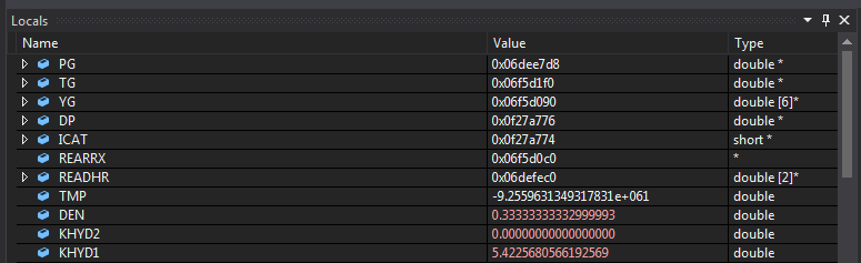

This a similar question to the one posted in https://software.intel.com/en-us/forums/topic/539492. In my case I have a mixed application .NET + Fortran DLL using VS 2013 and Fortran Composer 2015 Update 2.
There are few things not working properly in the debugger. These are related to the following code:
pure subroutine ReaRateFT(PG, TG, yG, dp, icat, ReaRRx, ReaDHr) != K, =Pa, [ReaRRx] = mol/s m3S, [ReaDHr]=J/mol real(8), intent(in) :: PG real(8), intent(in) :: TG real(8), intent(in) :: yG(IIc_FT) real(8), intent(in) :: dp integer(2), intent(in) :: icat real(8), intent(inout) :: ReaRRx(1:IIr_FT, 0:2) real(8), intent(inout) :: ReaDHr(1:IIr_FT) ! Local variables integer :: iWGS ! WaterGasShift index integer :: iHYD ! Hydrogenation index real(8) :: Pbar ! Pressure [bar] real(8) :: kEq ! Equilibrium constant real(8) :: kWGS1, kWGS2 ! real(8) :: kHYD1, kHYD2 ! real(8) :: den, tmp real(8) :: dummy(2,2) ! WaterGasShift and hydrogenation indices iWGS = 1 iHYD = 2
1) The local variables displayed are the followings (see attached Capture1.png). Note that there are a lot of variables missing. Also there are slots with a tiny symbol and no description or value. Furthermore the value field displays the pointer address instead of the actual value of the variable (as it did in VS 2010).
2) Now if the dummy(2,2) variable declaration is removed the list of local variables is more complete (see attached Capture2.png)
... but still with the value field contains pointer address -like information. More importantly I do not have access to ReaRRx which is a 2 dimensional array.
3) If I try to watch a global variable (module_name%%varname or module_name::varname) it is not displayed.

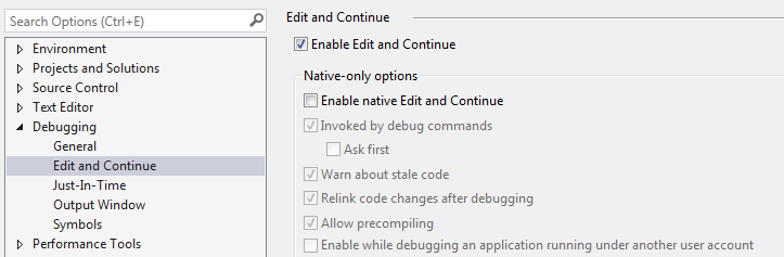

It is clear from your screenshots that the Fortran debug support is not loading. Make sure that in Tools > Options > Debugging > Edit and Continue that "Enable native edit and continue" is NOT checked.
Dear Steve,
Thank you for your prompt reply. After having the "Enable native edit and continue" NOT checked, all problems mentioned still persist. The screens captured below were taken after changing the mentioned option and VS was restarted and the project rebuilt.
