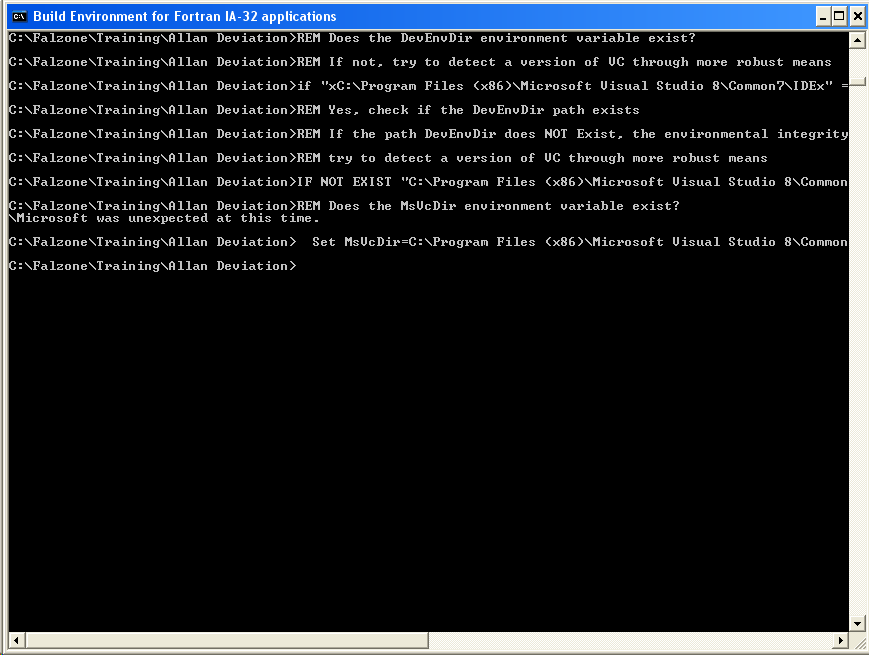

Intel_C_Intel
1,900 Views
I turned echo on and attached the results as you asked. Also, I verified that the files are their. Vcvars32.bat was there but not capatilized. I changed that after I took the screenshot, but it made no difference. Same error as before.

Intel_C_Intel
1,900 Views
Hi Again,
Here is more information that I discovered. I was checking all the paths and they seemed ok. So then I turned echo on in the next file that IVF was calling. That was the bat file for the Platform SDK. Then what you were probably looking for showed up. I attached a picture. I don't know what it means though. Also, the thing I don't understand is all of the command prompt windows for the SDK and the one for C++ all open without a problem. So I don't know why the Platform SDK batch file is having an issue when called from the IVF command prompt window.

Hi Steve,
I think I fixed it. I changed the vsvars32.bat file as follows:
@SET VSINSTALLDIR=C:Program Files (x86)Microsoft Visual Studio 8

Moreover, I added the following line to the existing file:
@set MsVcDir=DevEnvDir
It seems to work now. I'm going to see if someone using a 32bit can run the executable, if so, its finally fixed.
Thanks for your help,
Anthony

I did fix the problem. A few co-workers checked to make sure the executable ran on their 32-bit computers. So you can download the free Microsoft C++ Express Edition andthe Windows Platform SDK and use IVF to target 32-bit computers, when running from Windows x64 edition. You just have to modify one of the batch files.
