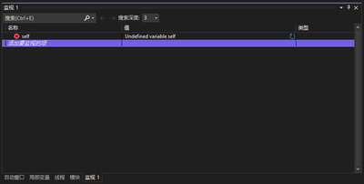

Variable "self" cannot show in VS watch when debugging:
WangWJ_0-1736134410530.pngWangWJ_0-1736134410530.pngWangWJ_1-1736134464184.pngWangWJ_1-1736134464184.png
Is there anyone can help me?

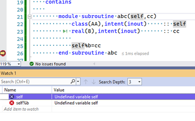

Another of the many cases the debugger has problems with. The latest FEE patch is applied to my system and that does not fix this one.

Thank you for reporting this. I have escalated to Debugger Engineering.
Devorah_H_Intel
2,137 Views
This issue will be fixed in the upcoming 2025.1 ifx release:
