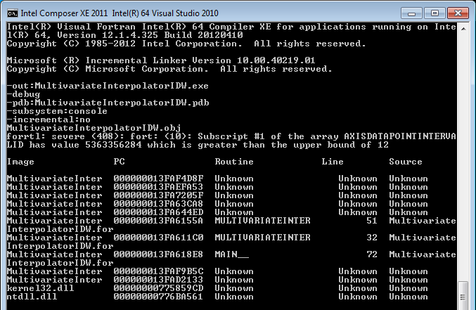

I’m getting an error, which is really strange and i don’t understand why.
I have attached a reduced version, so that only the relevant code lines are included. I have also attached a screenshot of the error message.
I’m using the intel fortran compiler: 12.1.4.325 Build 20120410 with the Microsoft visual studio 2010.
The compile flags: ifort /debug:full /Zi /Od /traceback /free /w /check:all MultivariateInterpolatorIDW.for
I have found some modifications, which don’t cause an error, but it makes no sense to me, that the attached one is not working. I hope someone can explain it to me. Do i violate a fortran specification without knowing? Thank you for reading.

      module MultivariateInterpolatorIDW
        implicit none
        private
        integer, parameter :: r15 = SELECTED_REAL_KIND( 15, 307 )
        integer, parameter :: i18 = SELECTED_INT_KIND( 18 )
        public :: MVI_interpolate
      contains
        subroutine MVI_interpolate()
          real( kind=r15 ) :: interpolatedValueV(1)
! local
          real( kind=r15 ) :: dataPerAxis(12)
          integer( kind=i18 ) :: axisDataPointIntervalId(12)
          integer( kind=i18 ), target :: axisIntervalIds(12)
          dataPerAxis(:) = 10
          axisDataPointIntervalId( : ) = 1
          axisIntervalIds(:) = 1
            interpolatedValueV( 1 ) = MVI_interpolateSub( dataPerAxis, axisDataPointIntervalId, axisIntervalIds )
        end subroutine
        function MVI_interpolateSub( dataPerAxis, axisDataPointIntervalId, axisIntervalIds )
! in
          real( kind=r15 ), intent(in) :: dataPerAxis(12)
          integer( kind=i18 ), intent(in) :: axisDataPointIntervalId(:)
! inout
          integer( kind=i18 ), intent(inout), target :: axisIntervalIds(:)
! return
          real( kind=r15 ) :: MVI_interpolateSub
! local
          real( kind=r15 ) :: weights(12)
          weights( 1:12:2 ) = dataPerAxis( axisDataPointIntervalId( 1:12:2 ) - 1 + axisIntervalIds( 2:12:2 ) )
           MVI_interpolateSub = 0.0
        end function
      end module
      program main
        use MultivariateInterpolatorIDW
        implicit none
        call MVI_interpolate( )
      end program

andrew_4619
4,083 Views
It is clearly a compiler bug. 12.x is very very old, the bug does not exist in current version!
I would not spend any time thinking about this!  Either use a newer compiler or apply one of the many workarounds you already know.
